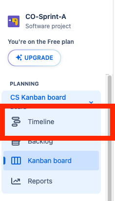

The basic Timeline feature available from the navigation panel on the left when viewing a board...
...will not be able to show you the hierarchy of an Initiative as a parent of an Epic which is a parent of other issues. That basic Timeline is only capable of showing the Epic and its child issues.

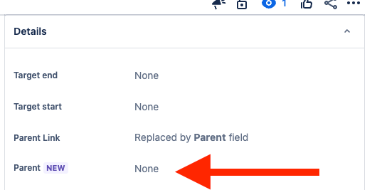

1. To add an Epic to an Initiative you would modify the Parent field in the Epic and insert the issue key of the Initiative.

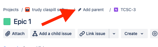

2. When viewing the Epic click on the Add Parent option in the breadcrumbs at the top of the issue.
