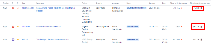

In most issues "Time to next support step" counts normally, f.e. issues below were created today. "Due date" is today and "Time to next support step" is also today, so the time frame is correct:

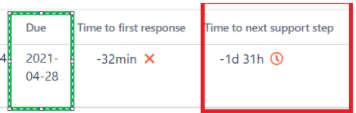

Although, in the example below "Time to next support step" counts time like this, even though due date didn't count down to an end (issue created on April 23rd). As you can see, the following "Due date" is 2021-04-28, the issue was created on April 23rd and where I marked on red ("Time to next support step") for some reason  the SLA has been breached:

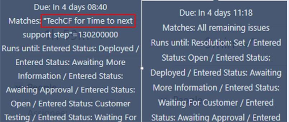

Also, some thing I noticed, that a few issues I checked has this difference:image.png
On the left, time tracking of "Time to next support step" is correct, on the right - breached. Do you have any ideas?

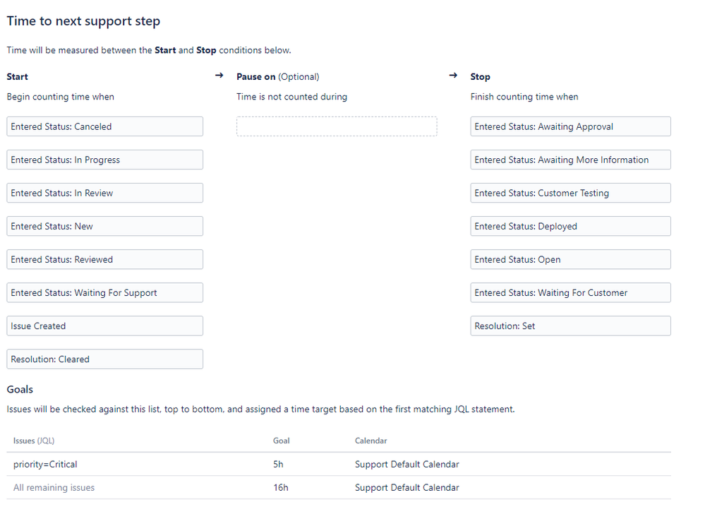

Can you please explain how your SLA "Time to next support step" is calculated?
Jira Softera
May 27, 2021
Hello @Manon Soubies-Camy
Thank you for a reply. Here is the time to next support step calculation for most of our projects:image.png
