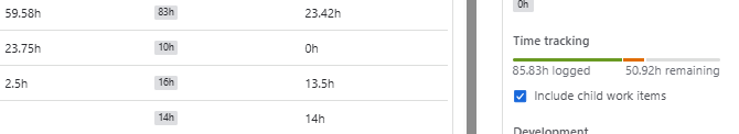

Hi there,
I've read a lot of posts but cannot see a clearly defined solution for this issue where the time remaining on a Jira project isn't calculating correctly.
Example shown below.
The order of the columns are: Time Spent, Original Estimate, Remaining Estimate.
The graph on the right hand side represents the overall time tracking.
The amounts shown as logged, is correct.  However, the time remaining is not correct because you can see in the second row 23.75h have been spent of the original 10h.  The delta of 13.75h is represented correctly in the graph.
So, if you do the math the total Original Estimate = 123h minus Time spent 85.83h should equal 37.17h.
Any help would be greatly appreciated.
Thanks,
Gary

The original estimate is not represented in this graph. The simplest explanation is:
  • At the beginning, when you enter a value in Original Estimate, it is copied to Time Remaining — and that's correct.
  • From that moment on, these two fields become separate. This means you can adjust Time Remaining at any time (for example, during time logging).
  • The only place where you can see you're off track with time is the orange field. It shows the difference when Time Logged + Time Remaining is greater than the Original Estimate. I assume that this orange field is exactly 13,75 (50,92-37,17)
I hope this helps! It’s not really intuitive, I agree.

Hi Wojciech,
Thanks for that.
Yes, you're right the orange represents 13.75h over original estimate.  However, what I was hoping for was the Remaining Estimate column to go into negative by 13.75h.
Which would then mean that the graph should display 37.17h, which takes into account the total time spent across all tasks, including those that have gone into the negative to give the overall time remaining for the project.

Hello Gary,
A negative value of 13.75 in Time remaining, both in practice and by definition, would mean that someone has to return to you the 13.75 you spent on the task. Such a situation doesn’t exist in the real world.
Remember that Time remaining refers to the current remaining time and is not connected to the Original estimate.
The Original estimate refers only to the initial estimation and is not really related to the current remaining time.
That’s how it works from the business side. What you're looking for is more like a field showing the relationship between the initial estimate and the remaining time — but such a field doesn’t exist. It’s only represented visually as a color on the progress bar.

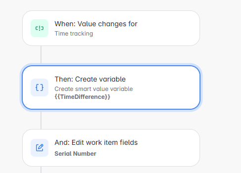

You are right, such situtation happens and you can track it in jira, but you should use more aggregation tool, than try to display it on the particular work item. I would recommend you to use Time Tracking Report (project report). At the end you have summary and data which you need. If you want to split data (into packets of hours, for example) then doing so from the Version functionality seems sensible.
If we are talking about Automations or ScriptRunner (additionally paid) we have to calculate:
"Original estimate" - "Time remaining" = X
With Automation Rules:
Something like that should help (we are calculating for field Serial Number). Smart Value in the "Create variable" is:
{{ issue.timetracking.originalEstimateSeconds | minus(issue.timetracking.remainingEstimateSeconds) }}
