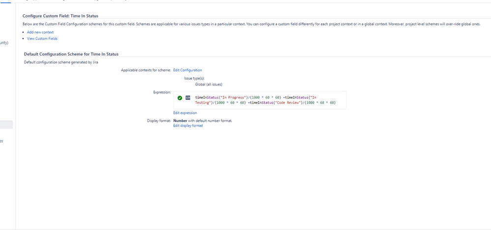

here is the code do you know how I should set it up to see number of days please ?
Ah, ok, it's not a time-in-status field, it's a calculated field, based on functions that look at the actual time in status.
That's fine, but the trick is to understand that most computers work in "epoch time" - that is, a date/time is actually just a number of milliseconds elapsed since a base date. And for consistency, most represent lengths of time in a number of milliseconds.
For an hour, you would find 3,600,000 in the database.
Your expression is reading three durations out, and dividing them by 1000 to get seconds, 60 for minutes, then 60 for hours.
So to get days, add a *24 to all three formulae.

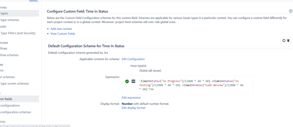

Hello, thanks I did the follow up as you advise here it is and the result is wrong, below the formula
And here screenshot of the information, I check with person assigned to the ticket for just few estimation seems to be okay and for others it is not at all.
What I can do to know from where the issue is coming please ?
You need to add the *24 to each of the three calculations on the fields, not the overall result.
