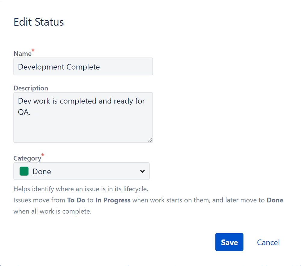

David
October 25, 2021
Please see attached screenshot. The status is set to a category of "Done". I was hoping to use this status as it is more descriptive than just Done.2021-10-25_9-18-38.png
Tessa Tuteleers
October 25, 2021
@Fabian Lim , if the status is - as mentioned - green, it should be in the right category. On cloud, the location of the column is of importance as well (strangely enough), and not only the status or resolution.
