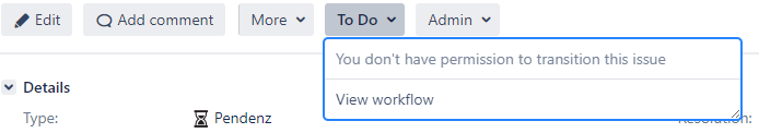

On Sunday between 11 a.m. and 8 p.m. tickets were not created correctly. I can see them, but no automation rules were executed and I now have no authorization to trigger a transition. (The automation rules didn't run on errors, but not at all)
Does anyone know this problem and has a solution for it? If I clone the tickets, the new tickets then work correctly. However, there are tickets that are created from a different system and I can't simply clone them because of the links etc.

I am an administrator and have permission for all tickets. In addition, the tickets work as desired before and after this time.
I would be interested to know how I can solve the problem so that I can still triage the tickets (without cloning the ticket)
At the moment I can only archive the tickets and not close them.

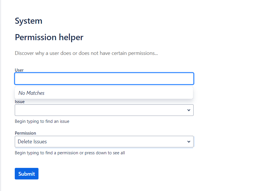

Go to Permission helper.
Press Control + K and type permission helper and check what is the permission missing.

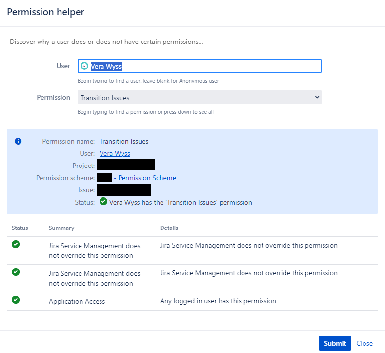

i already checked this, the Permissions are correct.

Muhammad Moazzam Hassan
September 25, 2024 edited
Then check the workflow properties and conditions, the permission must be controlled via workflow properties.
