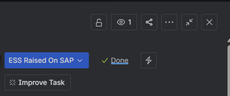

Further investigation, I've noticed that inside the tickets, they are marked as done next to the status. This is an in-progress status, and Jira seems to have automatically assigned it as done. Any help to get Jira to stop doing this, I would be grateful.

I found the solution.
The status used to be a done status, but was changed to an in progress one. For tickets predating this change, they still seem to have an automated hide rule that all done tickets have, and moving them out and then back into the status makes them reappear.

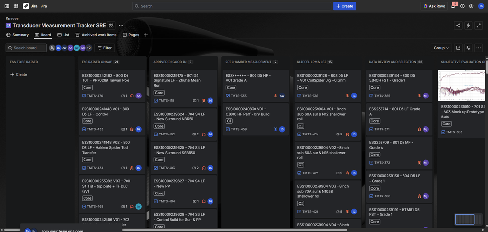

Can you provide screen images that show the board with the items hidden, and then a screen image of the details of one of the hidden items? Hide confidential data. I'm interested in the Status, Type, and Resolved and Updated dates of the affected issues.

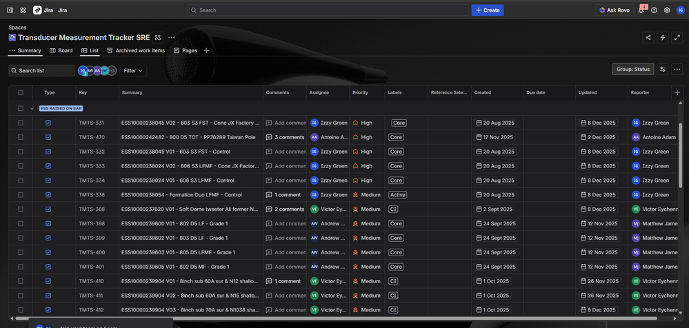

I see you have added a couple of screen images to your original post. Which issues shown in the List image are missing from the board image?

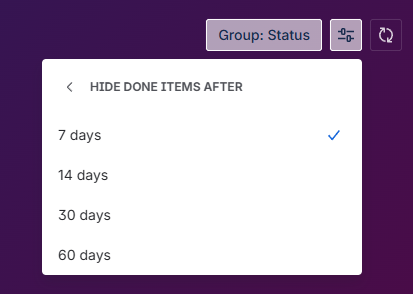

You made the comment that you "turned off" the option for hiding done items. The ability to turn that off did not used to be available for a Team Managed Software space Kanban board. I may have missed the release of that feature. Can you provide details and screen images showing how you are turning that option off?

In list view, you can toggle hide done items under the view settings. The issue is with tickets that are in "in progress" columns; the only done column I have in the board is set to hide after 60 days, which you are correct, can not be turned off.

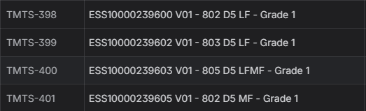

The following are examples of some tickets that do not show on the board.

From the list view I can see you are grouping by Status and the 4 issues you specified are under the ESS Raised On SAP status.
From the board view I can see that is the heading of the first column, and the column header indicates that there are 21 issues in that column.
In the board view are there, in fact, 21 issues displayed in that column?
In the list view how many issues are listed in the ESS Raised On SAP group?
Isabel Green
December 9, 2025
Hi Trudy,
21 is correct for the amount it is showing on the board. The amount in the status is actually 37, so 16 tickets are not showing for some reason.

Regarding Done items, there's the Hide Done Items After setting in the upper right corner:
Other filters should (at least by default) not be affected by a timeframe. Nonetheless, ensure that no additional filter is set.
