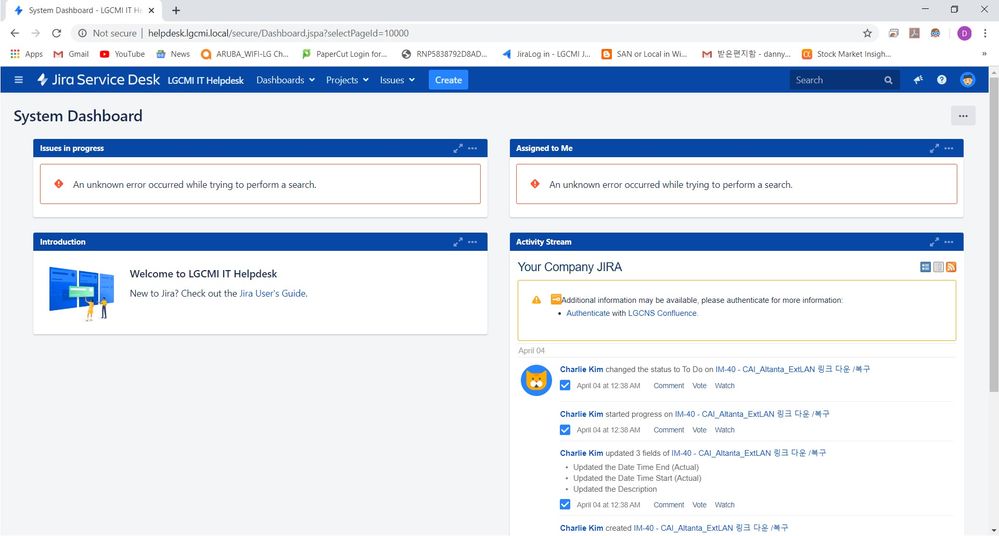

Tickets created after May 12, 2020 have its ticket # but cannot be searched or filtered.
Danny Kim
May 18, 2020
 Instead the error message "An unknown error occurred while trying to perform a search." when performing a basic search.

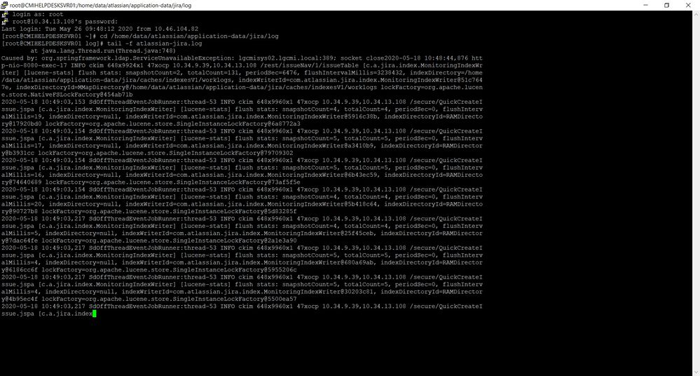

I got what you asked.
Please find the image shown above to find some clue for resolving the issue.
Thank you for your help, Nic.
Nic Brough -Adaptavist-
May 26, 2020
There's not enough of the error log here to tell us much.  Although there's clearly a problem with your LDAP connection which needs fixing.

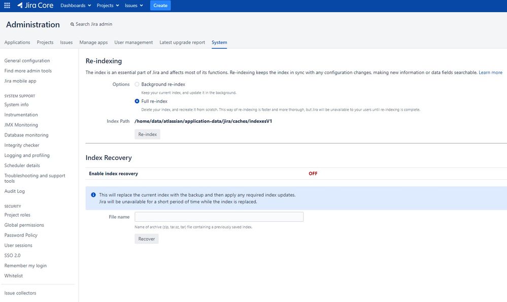

Um, your supervisor appears to have destroyed your index, so I'm not suprised searches are failing.
For re-indexing, you should use Admin -> Index -> Rebuild index (use the full locking one).  That applies for repairing the damage that's been done here too.  It will rebuild it from scratch, re-creating the files it needs.
Danny Kim
May 18, 2020
Hi, Mic Brough.
If possible, can you give me step-by-step guide?
I'm totally new to JIRA need an illustrated instruction works best for me.
May 18, 2020
It really is as simple as
Log in as an admin.  Go into the Admin menus (cog at the top right near your profile picute) and look for "indexing".  Use . or the search-admin field towards the top left of the screen to search for "index" if the menus are a bit overwhelming.

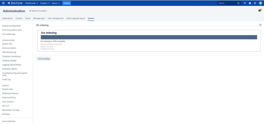

Danny Kim
May 18, 2020
Performed re-index from what you asked but looks like the issues is remained.
What if it is not related with indexing?
The error message is only occurred when having an issue with indexing only?
Please advise.

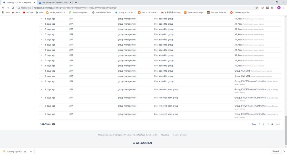

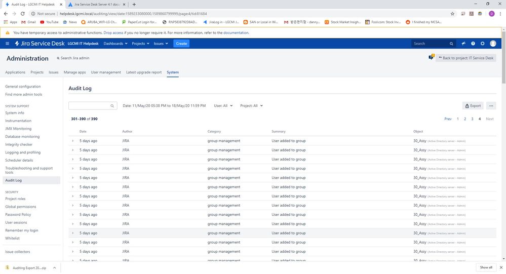

Audit_Log screen since May 11,2020 as shown below.
May 18, 2020
We need to look at the application logs as I said before, not sure why you've looked at the audit.
May 19, 2020
Could you tell us what the logs say as the dashboard fails to render?  I don't have the time to plough through some-one else's log with no idea when the error may have happened.
Danny Kim
May 19, 2020
Sure, what's the keyword that I can find for the dashboard rendering failure?
May 23, 2020
I don't know - that's what we're reading the logs for.
The easiest thing to do is if your server is a Unix-like system.  You log in with a terminal emulator, go to the logs directory and use "tail -f atlassian-jira.log".  This will give you the last few lines in the log, but it will update if more are written.
So then go to Jira, and provoke the error again.  The errors we need to see will be dumped out by the tail -f.
I don't know of an equivalent in Windows.
