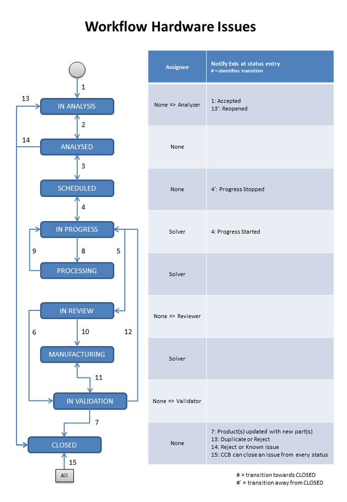

So I have a choice: Do I create a workflow similar to the current system, or do I create a more agile workflow.
I think an agile approach using KanBan will fit.
Basically my interpretation is: The Engineer picks the most important issue and is assigned to only that issue (with exception of some standalone processes).

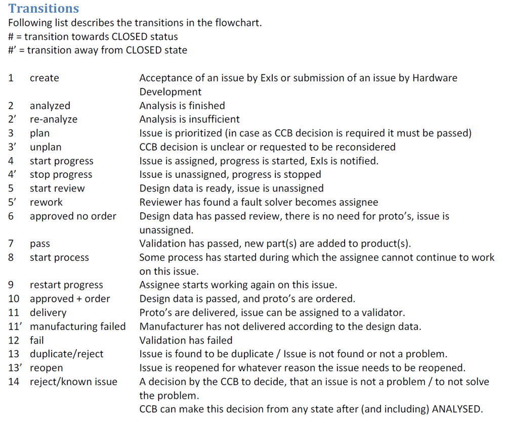

Agile Hardware Workflows are hard to find, so I tried making one.
Following images contain my proposal, it might violate some Jira "must haves" (like an open state).
Feel free to comment on it, but above all I would like to see and learn from your Hardware Development Workflow.

I will start of using this workflow for most of them, only subtask have a different, much smaller, workflow (Scheduled, In Progress, In Review, Closed).
The number of statusses is one of the reasons I posted this thread, because I think I am making it more complex than needed. So I would like to see what you use.

Since you can configure your workflows anytime, you could try out the workflow you created for a period of time. If you feel like there are too many transitions and statuses, some of them could become tasks or sub-tasks. For example if you think manufacturing doesn't have to be in the workflow, then it could become a sub-task.
Looking back at your workflow, I actually think the number of statuses are fine because they represent important stages in product development. Correct me if I'm wrong, the transitions automatically happen based on the activity in an issue right?

I think what you call compartmentalization is my way of trying to have an Agile workflow in which an Egineer works only on the most important task until it is finished before starting on the next. Because for HW-engineering you mostly wait for the complete design is ready before you start a "Build" and "Build" often take 6-10weeks, there is a long time of inactivity on a ticket between finishing progress and starting validation.
To have one in progress item on the board per Developer I created some wait statusses, "Processing" and "Manufacturing".
At this moment I am feeling that this is overcomplicating the workflow, and I feel more like accepting more than one issue/developer to be "In Progress". And thus removing the wait statusses.

As I learn more about the software progress the "In Review" step resembles a Pull Request in SW. Colleagues are reviewing the design data before going to the next step. With new designs (sometimes multiple) schematics are reviewed by several people also because there are SW-related elements. For the board design the review is mostly done by 2 E-engineers and one M-engineer.
In our software workflow this is not a specific state of the Jira ticket, but an element under a "Development" header. I think this has to do with the tooling used for designing SW.
