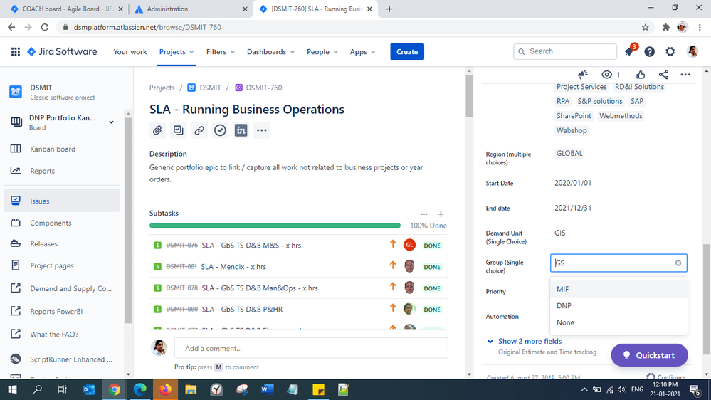

Hi Team,

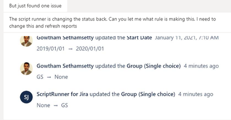

Can i get help on below snip? Why is this suddenly happening? any idea?
Hello @Anuradha Yadav
Can you check if you have a scriptrunner listener that change the value of your field.
Hi Anuradha,
I can confirm that you can check Script Listiners inside of your instance at the URL of <JiraCloudBaseURL>/plugins/servlet/ac/com.onresolve.jira.groovy.groovyrunner/script-events-admin?s=com.onresolve.jira.groovy.groovyrunner__script-events-admin
As Mohamed has mentioned it is likely that a script here is configured to change the summary on the issue and this is what is causing the behaviour which you are seeing.
Regards,
Kristian
You can follow the step here :
This is the filed group ()use want to change status to none.

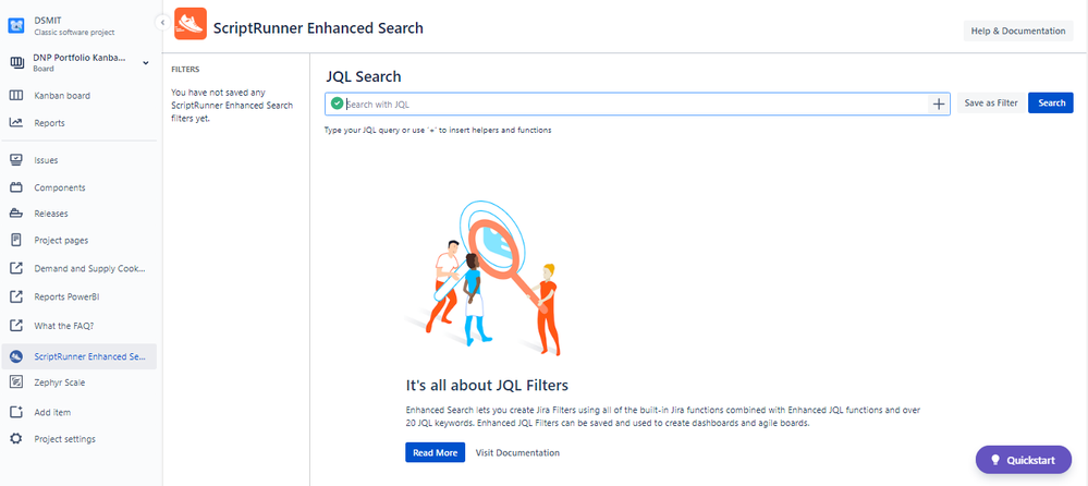

HI Anurdha,
On your screenshot, you are on the enhanced search page and not on the listener's page which is under the site admin pages and you can access using the link I provided earlier or using the steps in the page which Mohamed linked to.
Regards,
Kristian
use the link provided by Kristian, and make sure you have the jira-administrator right
Hi @Mohamed Benziane @Kristian Walker (Adaptavist) ,
Sorry i was checking in wrong page.
Now i Got it. As Im just 2 months in groovy. Can u please help me here.? where to see the changes for the group filed?

Just need to understand "I need to understand why I am not able to change the value of this field to None"
Hi Anurdaha,
Can you please confirm what type is the field you are trying to set to None and
If it is the status field you are trying to change, you cannot change the value of this field to *None* as Jira does not allow this and requires to change status you must transition an issue and you can only transition to an issue that the workflow has a transition to from the issues current status?
Regards,
Kristian

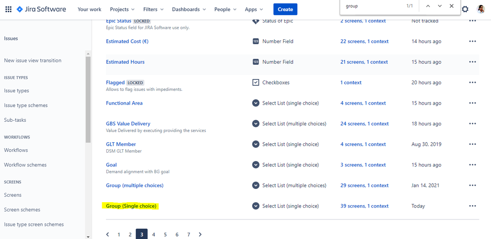

Hi, I see its a multifield selector.
does it help?

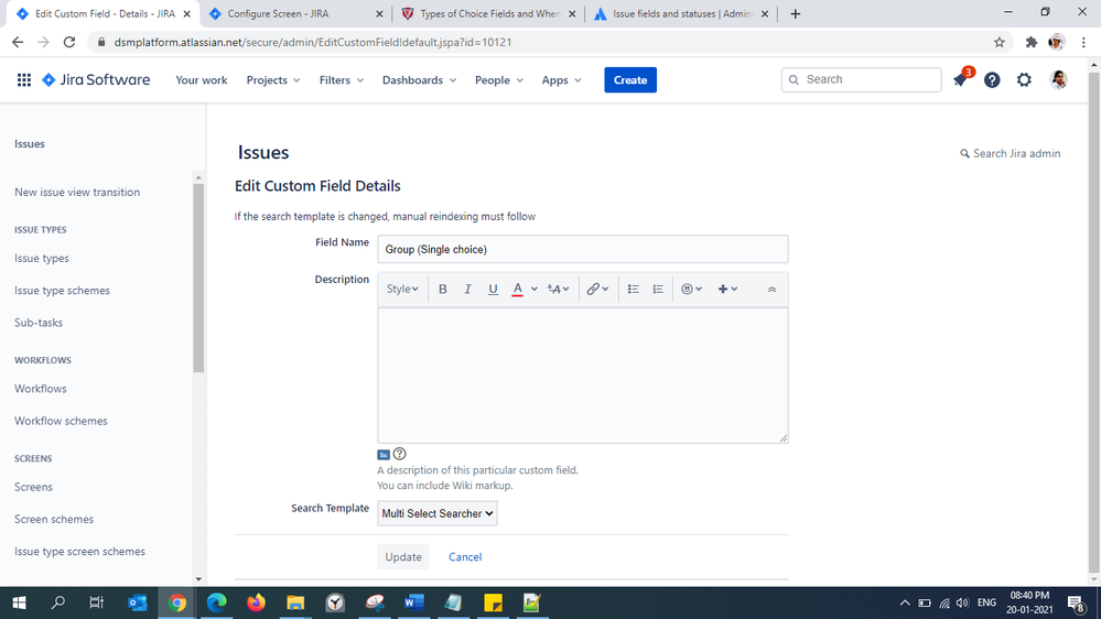

Hi Anuradha
Can you send go to the page at <JiraCloudBaseURL>/secure/admin/ViewCustomFields.jspa from before you click on the field and to confirm what type it says the field is in the Type column as I will need to know this type in order to advise further as your screenshot does not show the type of the field.
Regards,
Kristian
In the above Snip user wants to change status of group filed to none. But the script runner is now allowing

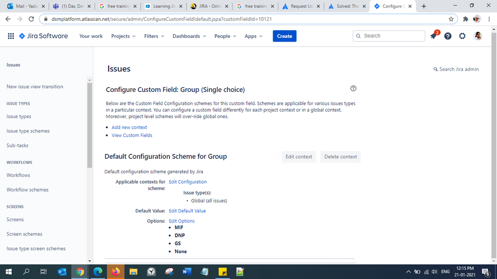

Hi Anurdhava,
Thank you for your response.
This indicates the field is a Single Select List field.
From the field, I can confirm it does not have an option configured called None so you cannot configure this to have a value of None unless you
However, if you want to clear the field so it has no value set then you can do this by setting the field value to null In your script to Null.
I can confirm we have an example script located here which shows how to clear values of different field types when cloning an issue and this script can be used as a reference guide to show how you can clear the field value for your Single Select List field named Group.
I hope this information helps.
Regards,
Kristian

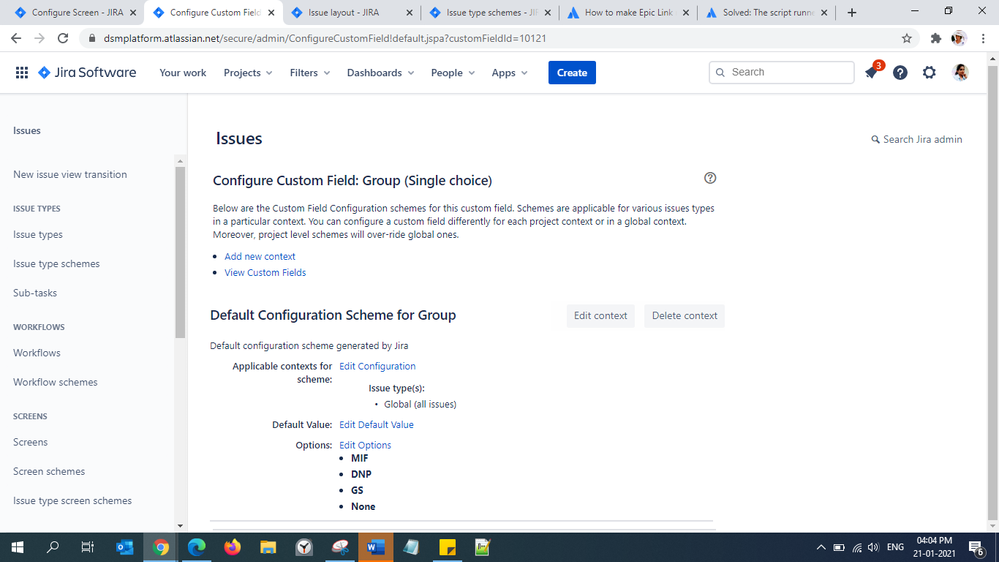

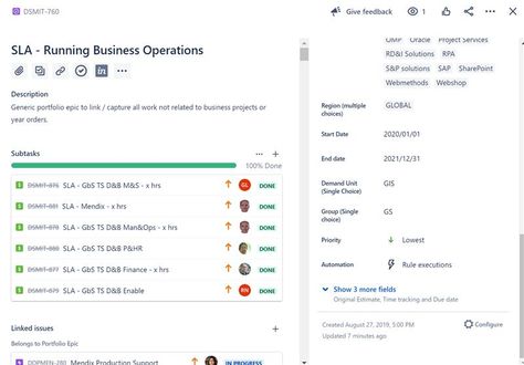

Hi @Kristian Walker (Adaptavist) ,
I see below options..
MIF
DNP
GS
None
So where to check why its not changing to None option.

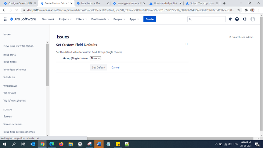

also default value is set as none as i see below:
Hi Andurdaham,
The None option was to shown in your last screenshot.
In order to set the value, you will need to use the syntax similar to shown in the example located here which can be run on the script console to show how to set an option value in a select list field.
You will be able to take the rest call here and use this as a reference guide to make a rest call in your script code to set the value of your field to none.
Please note that the examples I have provided have been tested and show how to set a field value and you will be able to use these to help refactor your script.
Please, note I can refactor your script for you and the examples I have given show how to achieve your requirement, so you will need to take these and use these to help debug and refactor your script to achieve your requirements.
