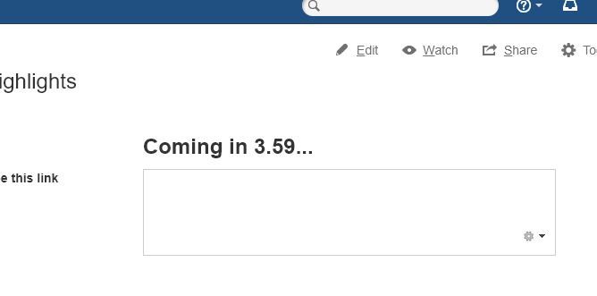

Jodi_Bulmer
August 21, 2019
I can see it on my dashboard in Jira, but trying to embed in confluence = :(
