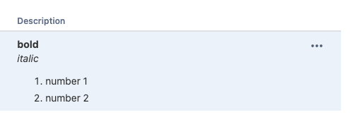

When I'm looking at filter results in the Advanced Issue Search screen I still see the rendered formatting.

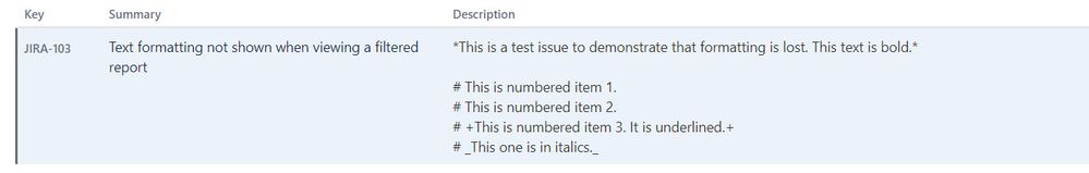

From the Dashboard page I click the Filters option at the top of the page. Then I click Advanced Issue Search. The results have no special formatting. This is what the result looks like.
*This should be bold*
#This is item 1
#This is item 2
#This is item 3
The text that is bold in the actual issue is surrounded by * and the numbered items all show # instead of the item number.
Can you provide a screen image?
In which field is the formatted text? Is it the built-in Description field or a custom field?
Sure. Here is a test issue I created with formatting in the built-in Description field. I included a screenshot of what it looks like when I go to the advanced issue search filter.

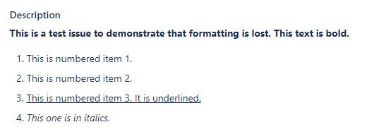

This is what the description looks like when viewing the issue.

What is the Renderer for the Description field in the Field configuration used by that project that contains the issue?

Search for "Description". You should see the Renderer called out here:
I have found that if the field shows "Default Text Renderer" here then you will get the results you are seeing. It would be necessary to update the Field Configuration to change the Renderer for the Description field to Wiki Style Renderer to correct the display in the Advanced Issue Search screen.
