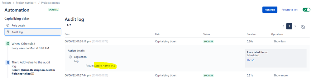

I just tried an example on my sandbox instance and created a custom field of type Text Field (multi-line) and it successfully used the function:
Are you using Jira Cloud?  What custom field type is the field you are having the problem with ?
