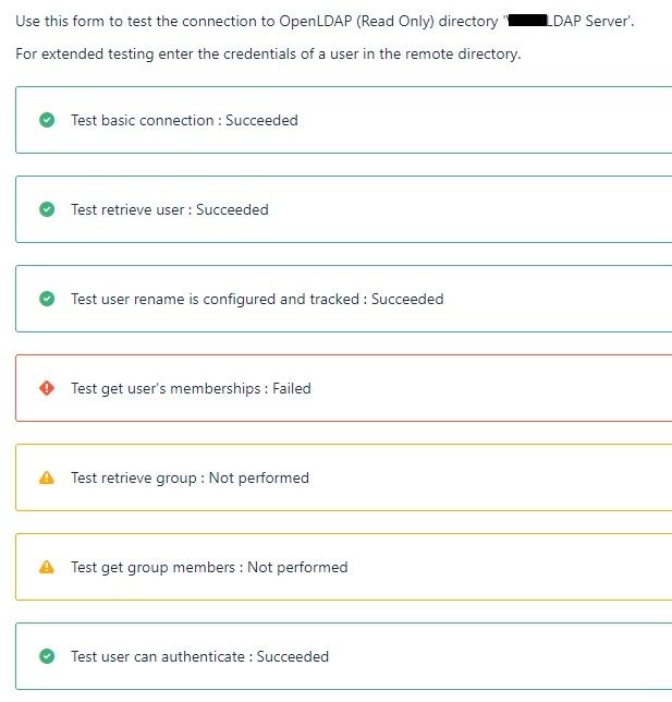

Hi,
I'm trying to configure JIRA with OpenLDAP user directory. But I'm facing  "Test get user's memberships : Failed" When doing the "Test Connection", I'm sharing full result when I'm test connection , I have also attached my jira server setup Screen Shot.
Output:-
Test basic connection : Succeeded
Test retrieve user : Succeeded
Test user rename is configured and tracked : Succeeded
Test retrieve group : Not performed
Test get group members : Not performed
Test user can authenticate : Succeeded

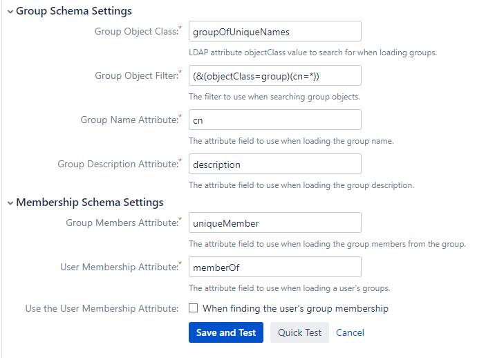

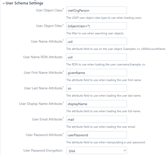

Hi, I have solved the problem, at least for my setup. The main problem for me was that I use an openldap docker image which has obviously a problem with the "memberof" method. The solution here was to use groupOfUniqueNames instead of groupOfNames for the groups like "jira-software-users", then the memberof call yields the expected results. Here my settings:
User Schema Settings
  • User Object Class: inetOrgPerson
  • User Object Filter: (objectClass=person)
  • User Name Attribute: uid
  • User Name RDN Attribute: cn
  • User First Name Attribute: givenName
  • User Last Name Attribute: sn
  • User Display Name Attribute: cn
  • User Email Attribute: mail
  • User Password Attribute: userpassword
  • User Password Encryption: SHA
  • User Unique ID Attribute: uidNumber
Group Schema Settings
  • Group Object Class: groupOfUniqueNames
  • Group Object Filter: (cn=*)
  • Group Name Attribute: cn
  • Group Description Attribute: description
Membership Schema Settings
  • Group Members Attribute: uniquemember
  • User Membership Attribute: memberof

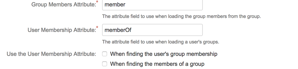

Hi!
Have you communicate with AD/LDAP admin?
looks like uniqueMember incorrect, could you try memberOf ?
Cheers,
Gonchik Tsymzhitov
amitpustode
March 16, 2019
@Gonchik Tsymzhitov  ... Yes, I tried with memberOf also but same issue ...
Gonchik Tsymzhitov
March 16, 2019
Like Anant Bhat likes this
amitpustode
March 18, 2019
@Gonchik Tsymzhitov ... that one also showing same error ..
