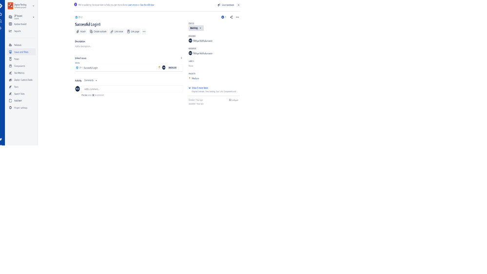

I created an issue and tried to edit the issue to include the test steps, test data and expected results. However, the issue does not display any test related fields.

Attached the screenshot of my test issue.

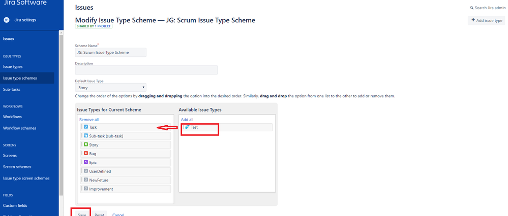

1. Go to the project settings >> Click on Issue Types >> Edit Issue Type
2. Add Test issue type to the current scheme
3. Now create issue with issue type Test, then you can see the test steps

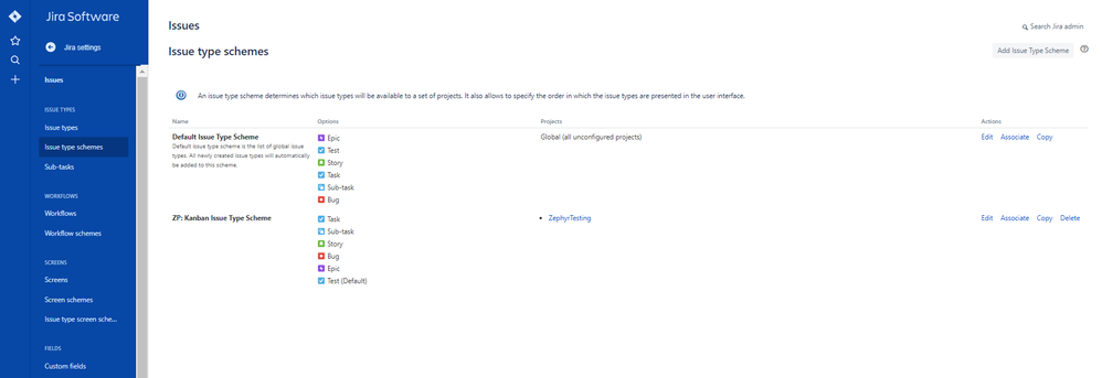

@jagadeesh madhura - the issue type "Test" is available in my current scheme.
This is for the Zephyr on JIRA Cloud.
My problem is that the created test does not show the "Test details" field to include the test steps, test data and expected results.
Since I am on trial version, not sure if downgrading by uninstalling the app is the best option.
Based on the Atlassian community discussions, few others too have this issue.

1.Once you install Zephyr it will create default issue type "Test", so please delete the manually created "Test" issue type from your issue type schema
2.Test Detail section will display only for the "Test" Issue type. From your 1st screenshot it looks like you have created a issue type of "Task".
3. Create a issue with issuetype " Test" and check for the Test details section.

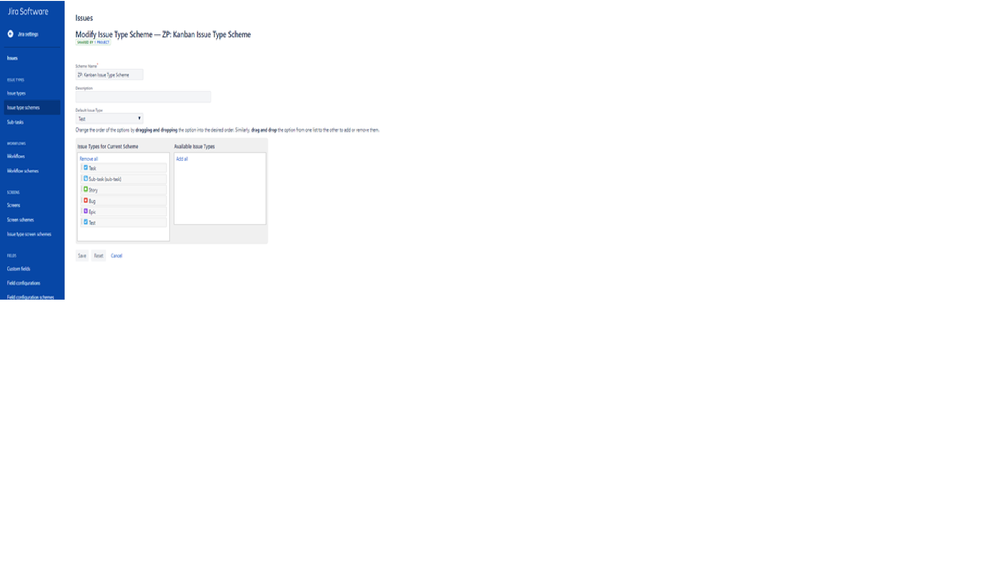

No need to create any issue type you should use the created one by zephyr and from your picture it seems like installed successfully.
check the created issue type and be sure it is linked to your project issue type scheme

Thanks for the response. the issue types are all linked to the project.
I am just not able to see the fields to enter the test cases
