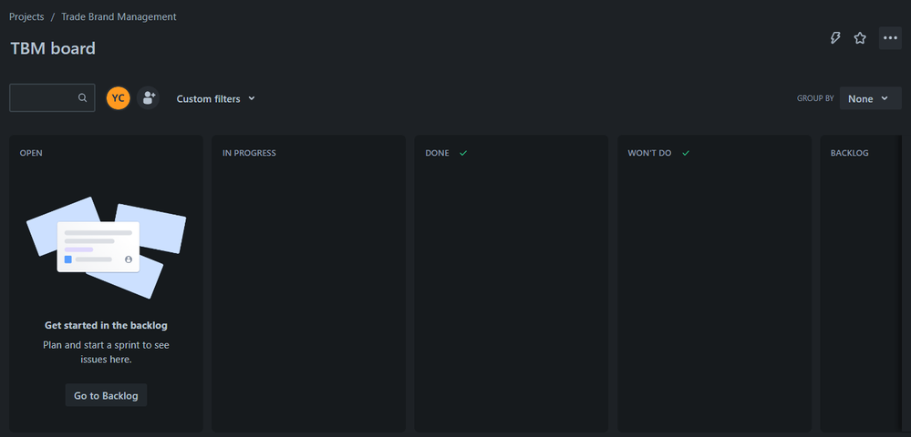

Hi there!
At the moment, my team works with a team-managed project. The EPICs and the issues can be all be found on the timeline, but unfortunately they don't show in the board.
At the moment, the issues are:
- assigned to a person
- status: is open, in progress or done
- all EPIC's have child issues connected through an automation
Is there a special setting too getting the issues on the board? Thank you for the help! If screenshots are needed, I will supply them asap.

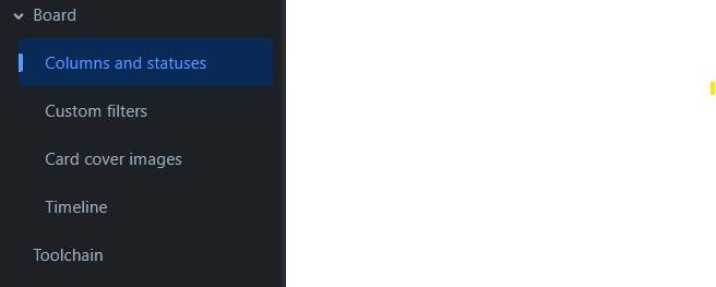

If I go to "Project settings" and afterward to the board menu, I can open the following options:

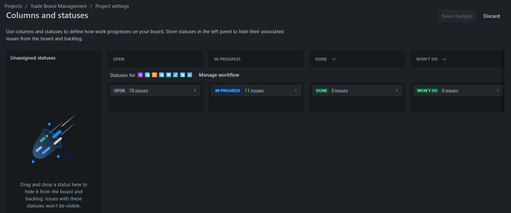

@Yannick Cejka
In the Column and statuses section, does it show any of the statuses having issues?
Is there a custom filter setup?
Yannick Cejka
July 25, 2023
@Tim Perrault Doesn't seem like it. It acctually see's the different issues and EPICs but they don't show on the board. There aren't any custom filters set yet.image.png

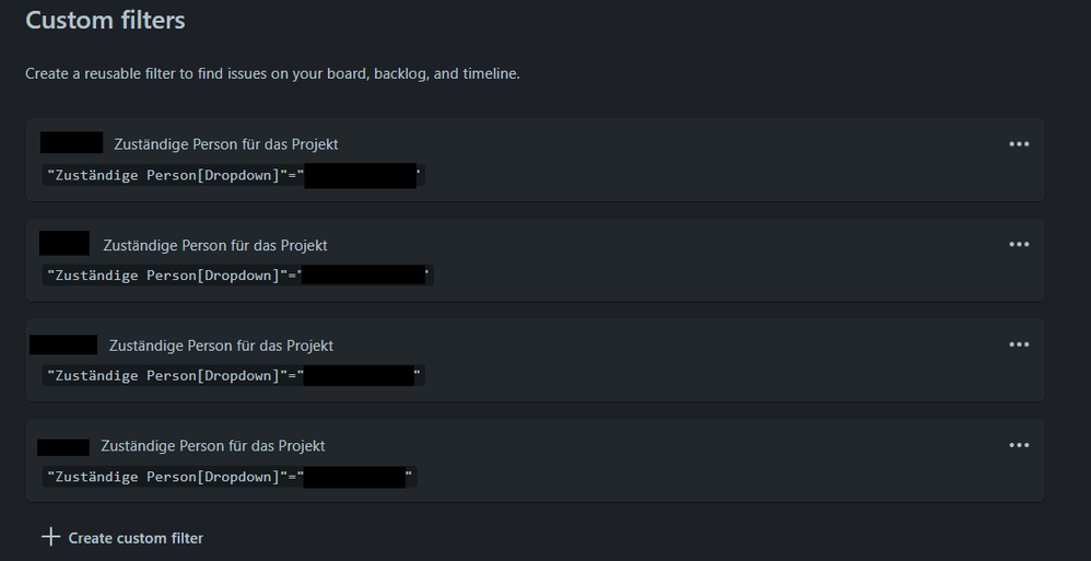

Yannick Cejka
July 25, 2023
@Tim Perrault I just checked, I do have a custom filter set. But it's just for an own created dropdown to filter the person in charge. But this shouldn't have any interference with the board?

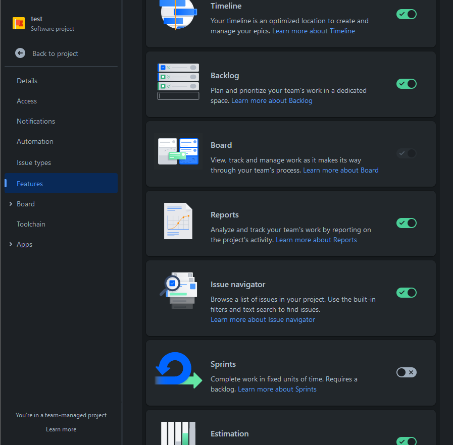

@Yannick CejkaI think I see the problem. Go to the projects settings and look under features. It looks like from that last screenshot Backlog and Sprints are enabled. Could you check to see if they are enabled?
Yannick Cejka
July 25, 2023
@Tim Perrault Timeline, Backlog, Board and Sprints are activated. Reports, Issue navigotr and estimation are not activated. Btw: thank you for your help.
Like Tim Perrault likes this
Tim Perrault
July 25, 2023
@Yannick Cejka Awesome, so with sprints enabled, you will have to create a sprint to have your issues show up on the board.
You could turn the sprint feature off, but I'm assuming you will eventually use sprints.
Trudy Claspill
July 25, 2023
Adding to this...
With the Sprints feature enabled the board will show only issues that are in Active Sprints.
It won't show issue that are in the Backlog nor issues that are in Planned Sprints that have not been started.
