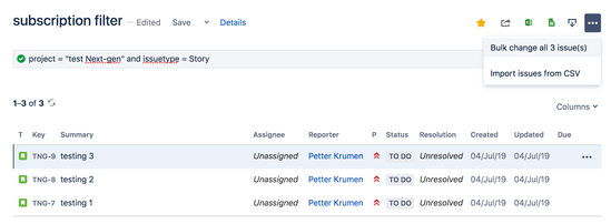

1 - Import your issues through CSV
2 - navigate to your issue navigator page and run a query to return all the imported issues
3 - Click in the three dots menu >  Bulk edit all issues

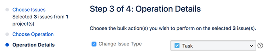

4 - Select the Edit issue option > Select Change Issue type > Finish the client
