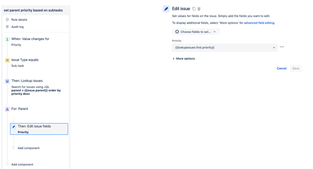

Trudy P Claspill
August 3, 2023
Hello @Douglas Oliveira
Are you using the built in Priority field?
If so, then a rule like this works.

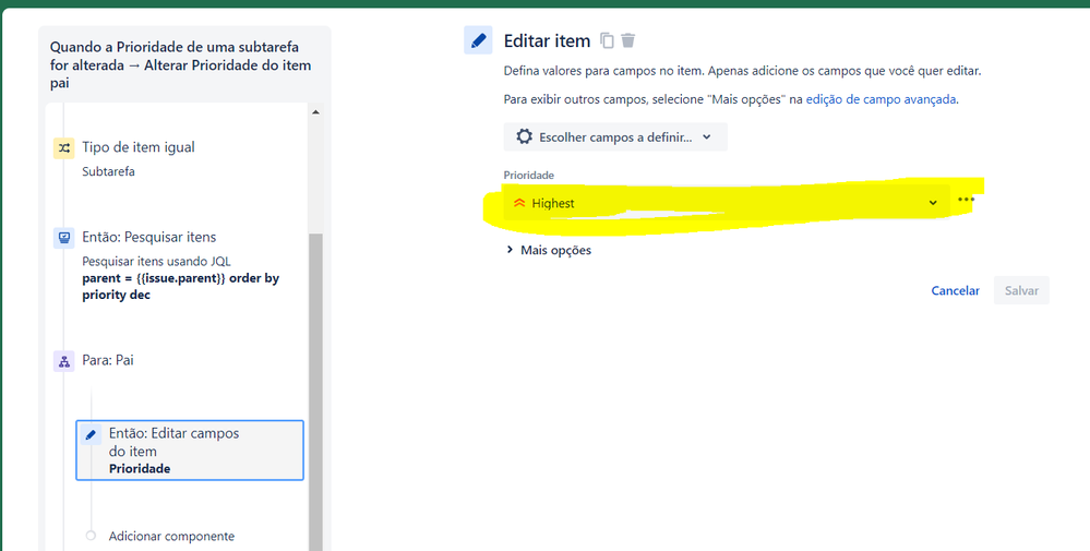

Douglas Oliveira
August 3, 2023
Hi @Trudy P Claspill ,
Yes i am using the built in Priority field.
But I dont have this option to edit.
I only can Set ou Copy in this option.
I am using a business project and i am the administrator.

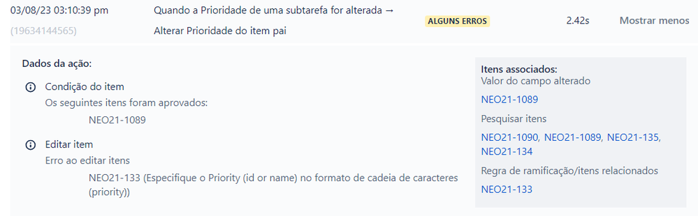

Douglas Oliveira
August 3, 2023
I was able to enter the code but it didn't work...
Trudy P Claspill
August 3, 2023
Yes, you would use the SET option and type in the smart value.
Please show the details of your automation rule and the details of the Edit Issue step.
Could you also paste as text the message in the log, so that I can run it through a translation app?

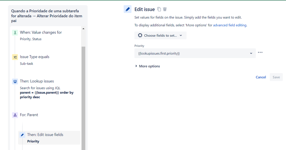

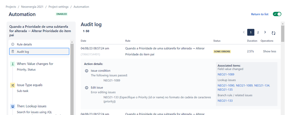

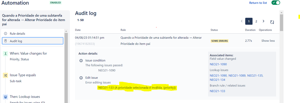

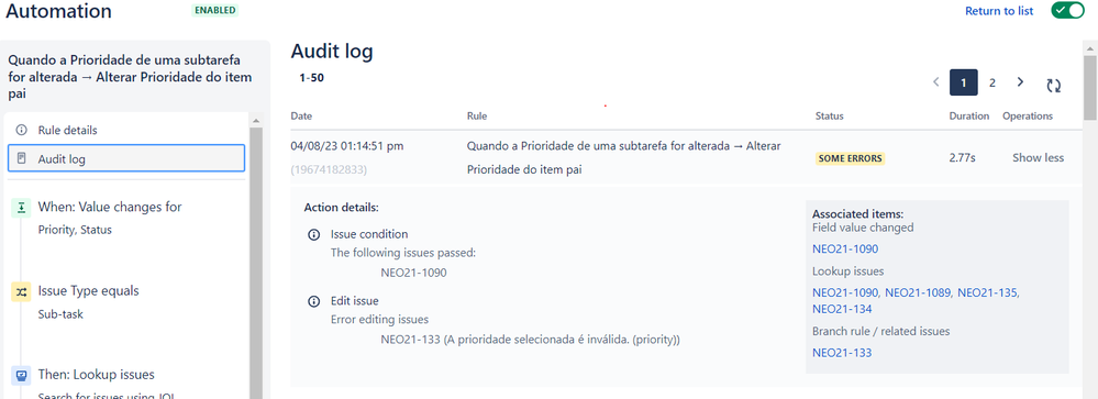

Douglas Oliveira
August 4, 2023
Hi @Trudy P Claspill , sure.
I change the Jira Languanges and this is the rule and the audit log:

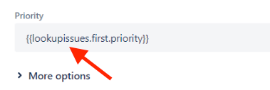

Trudy P Claspill
August 4, 2023
Where you have used the smart value to set the priority field, the "i" in "lookupIssues" needs to be capitalized.
Like Douglas Oliveira likes this
Douglas Oliveira
August 4, 2023
Thanks
I hadn't really seen this detail but unfortunately the watering doesn't work.
The translation of the text would be marked:
The selected priority is invalid. (priority)

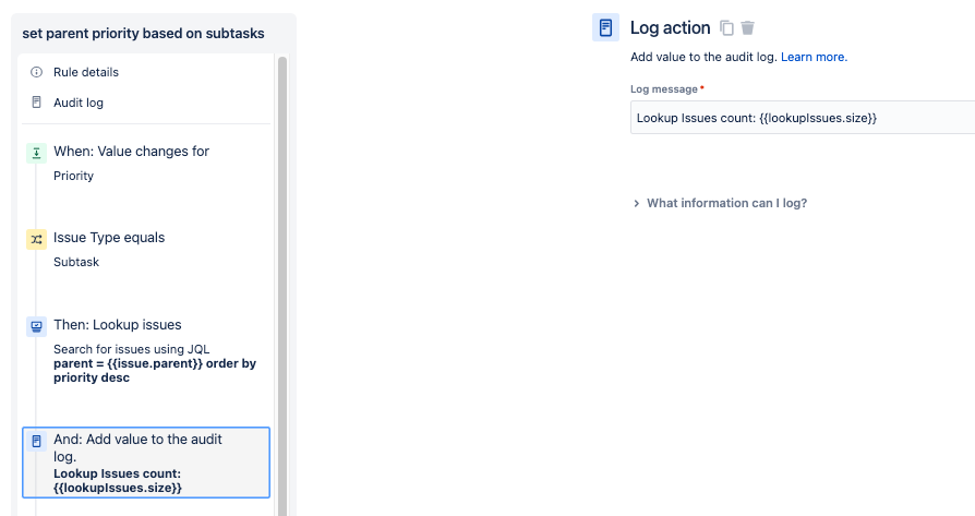

Please add a step after the Lookup Issues action to print the smart value for the count of issues found into the Log. This is done with the Log action.
Lookup Issues count: {{lookupIssues.size}}

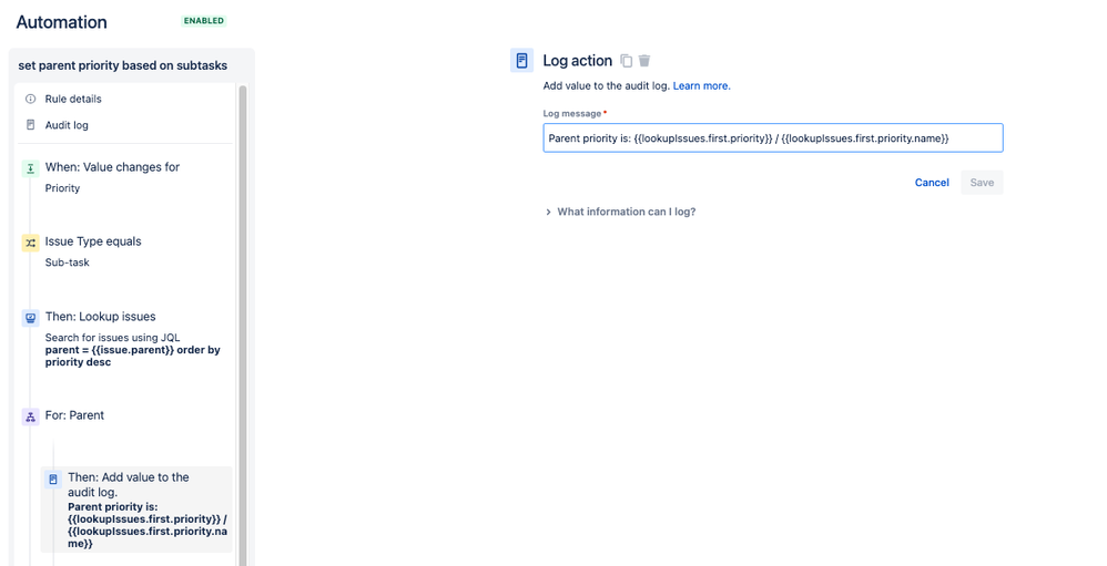

Please add a step before the Edit action to print the smart value into the Log. This is done with the Log action. Print both the value and the name associated with the value.
Parent priority is: {{lookupIssues.first.priority}} / {{lookupIssues.first.priority.name}}
Run the rule again and review the log. It should show you a numeric value for the count of issues found by the Lookup action and a numeric value for the priority and the text name displayed for that priority.
Is the count of issues found greater than zero?
Is the priority value a value that you could set manually on the parent issue?

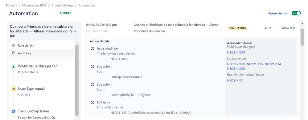

Douglas Oliveira
August 4, 2023
Thanks for answer @Trudy P Claspill ,
This was the result of the audit log.

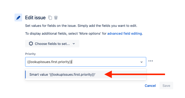

Trudy P Claspill
August 4, 2023
That confirms that the Lookup is finding issues, and the first one in the results set does have a valid priority value.
Can you show us the details of the Edit step again, since you changed it? I want to confirm that is contains the following without any typographical errors.
When you were entering the smart value, did is show you the pop-up below the field as you typed? And did you click in that area to insert the value you typed into the field?
Douglas Oliveira
August 4, 2023
It worked now, There was a space at the beginning of the smartvalue text...
Thank you very much @Trudy P Claspill !

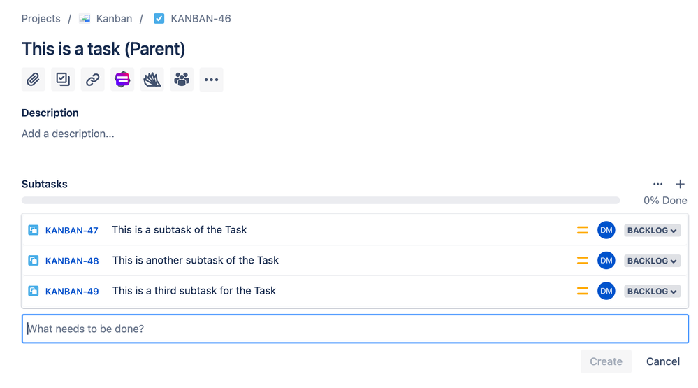

HI @Douglas Oliveira
In which view would you like to achieve this?
Task is always the Parent of its Subtasks, just as subtasks are always the child of their parent, the Task.
You can drag and drop the subtasks of a Task up and down (ranking) to determine the "priority".
