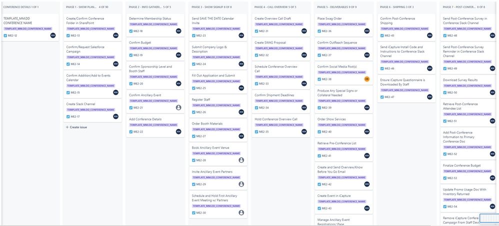

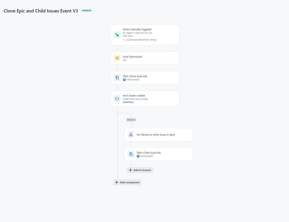

I have created the proper automation to clone an epic in Jira however when the Epic, all of the tasks, and subtasks are cloned it is placing all of the tasks into the same status instead of cloning them and keeping the existing status they are in when cloned. How do I create an automation to not only perform the cloning but to also clone each task and subtask and keep the current status it is in? This is the template I created to clone the epic from. Each task and subtask need to stay in their respective phase when cloned. I work in events and we do not use statuses in the same way as other areas of the business so the typical use cases for other teams in Jira do not apply to us. Thanks for your help!Jira Template Screenshot.JPG

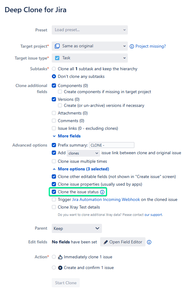

If you are willing to use a third party app, our app Deep Clone for Jira can help solve your issue by cloning epics, tasks, and subtasks while preserving their original statuses. With Deep Clone, you can ensure that all related items are cloned with their exact workflow states intact, avoiding manual adjustments post-cloning.

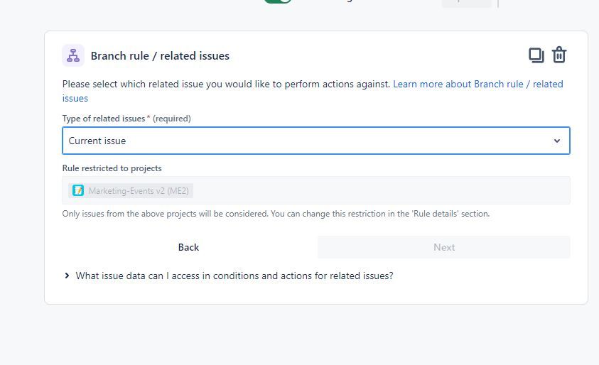

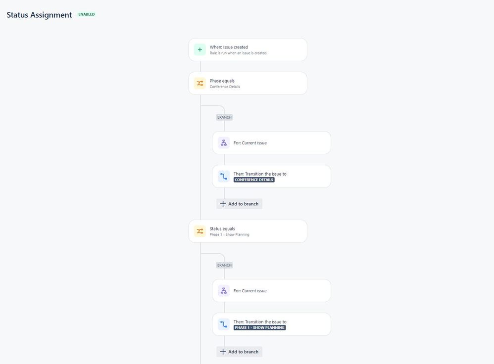

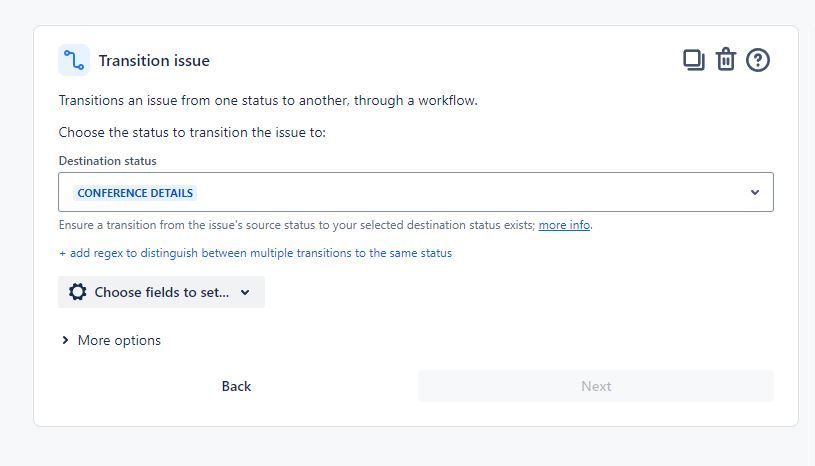

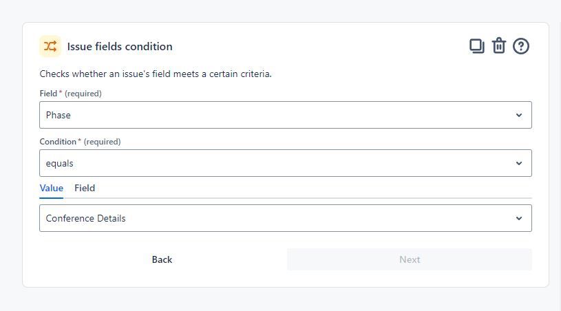

@Bill Sheboy I tried what I think you meant for the two rule approach above. It did not work so I am assuming I am doing something wrong. See attached photos of the rule I created. Jira Status Assignment Rule Screenshot.JPGJira Status Assignment Phase Condition Screenshot.JPGJira Status Assignment Branch Screenshot.JPGJira Status Assignment Transition Screenshot.JPG
Trudy P Claspill
December 2, 2024
Hello Heather,
When you say the rule didn't work, it is helpful if you tell us exactly what it did and did not do.
You don't need the Branch at all.

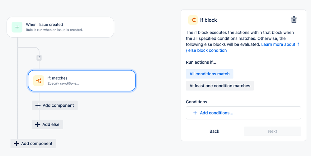

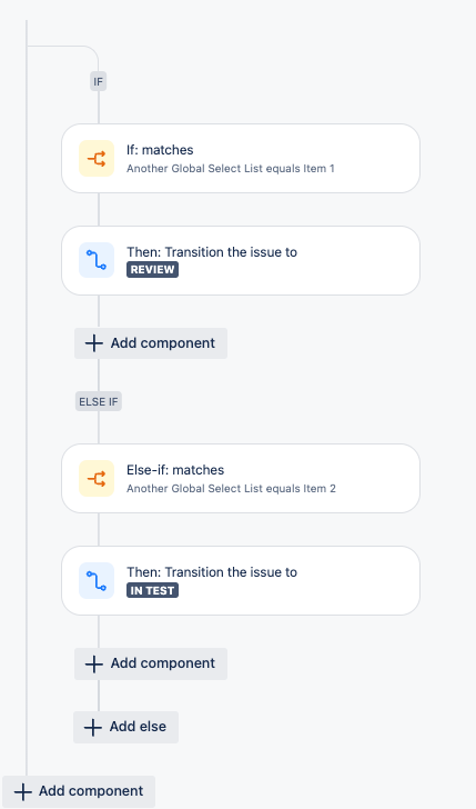

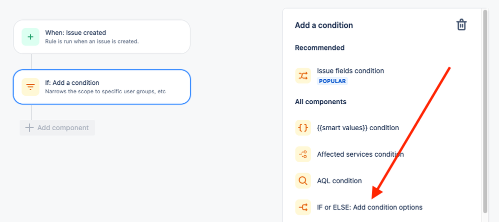

You do need to use an If/Else block. When you use a series of IF conditions the rule stops running when if encounters the first IF condition that fails.
With an IF/ELSE block you instruct the rule as follows:
If A is true, then do this step
Else if B is true, then do this other step
Else if C is true, then do a different step
After selecting the IF/ELSE option your rule looks like this:
You would add your first condition on the right where it says Add conditions. On the left you would click on Add component to add the Transition Issue action that goes with that condition.
Then on the left you would click on Add else to add the next condition and companion Transition Issue action.
Repeat that for each condition/transition pair.

You will, basically, need to add the Transition Issue action to change the status of each issue after it has been created. This will require that the workflow for the issues supports a direct transition from the initial Status to the desired Status without any Conditions, Validators or Transition Screens. The exact changes that will be needed depend on the current structure of your rule. You can either add the step to the existing rule, or you can create another rule triggered by Issue Creation to execute the transition.

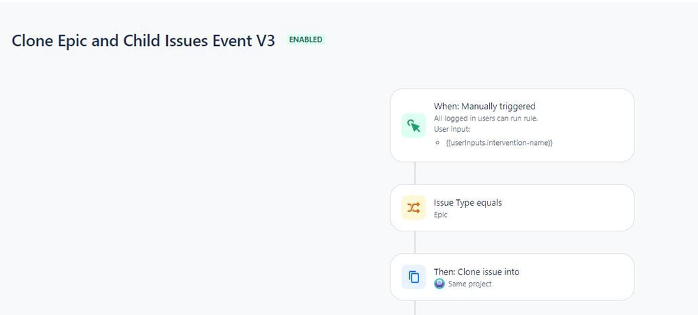

 Our tasks and sub-tasks stay in the same status until completed. We do not move them from one status to another. So to answer your first question yes we already have a rule that is correctly cloning the epic with all tasks and subtasks. Additionally, when I clone the Epic there is a section in the automation that will ask me for the new name of the Epic. When I fill in the name and select for the template to be cloned it does not change the name to the new name I entered and it adds the word CLONE to the Epic title. It also adds the word CLONE to the titles of the tasks and subtasks instead of cloning the titles as is which do not change from Epic to Epic. How to I fix this so the Epic title changes when cloned and the word CLONE is not added to the Epic title or any of the tasks titles?

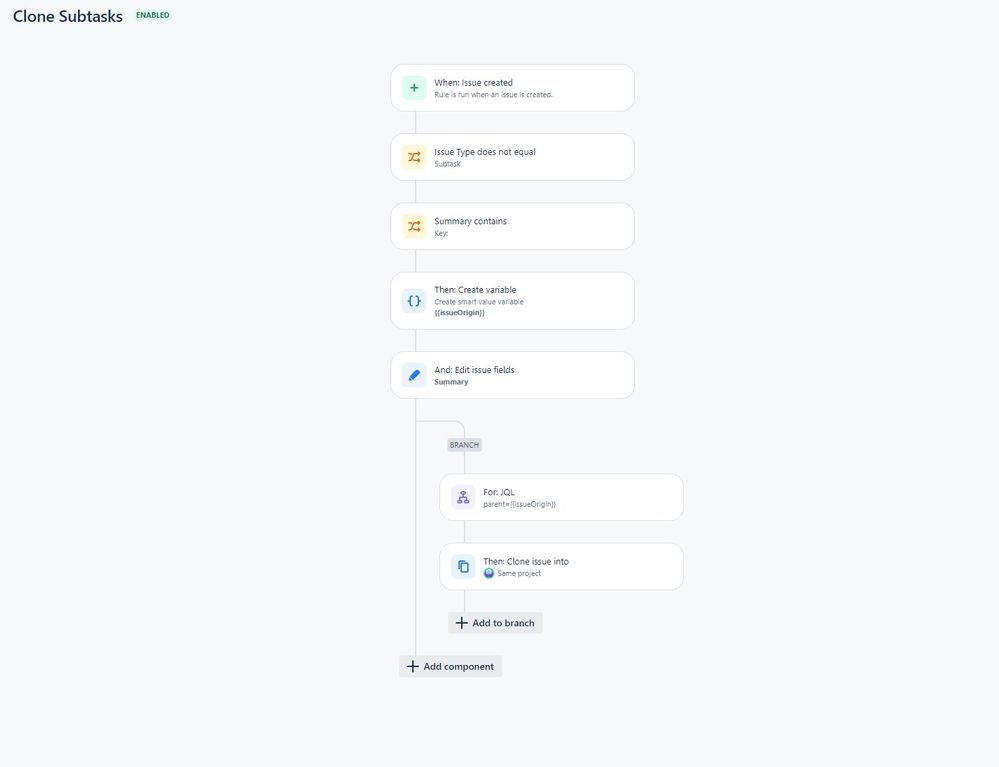

 See screenshots of Automations here:

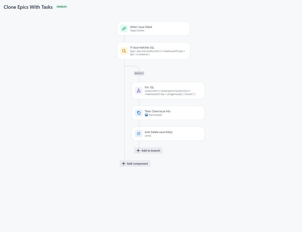

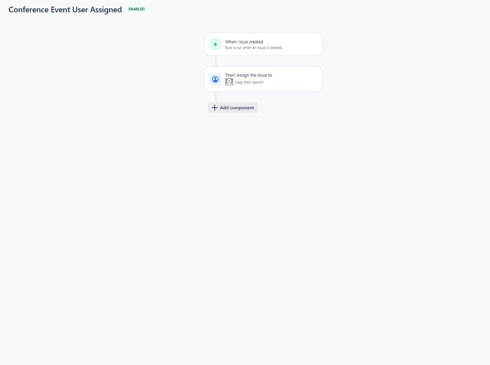

Jira Clone Epics With Tasks Rule Screenshot.JPGJira Clone Subtasks Rule Screenshot.JPGJira Conference Event User Assigned Rule Screenshot.JPGJira Epic Cloning Automation Rule Screenshot.JPG
There is a global setting that can be used to automatically add the "CLONE - " prefix to issues that are created through the Clone action. That can be changed only by a Jira Product Admin.
However, whether cloning manually using the Clone Issue action while viewing an issue or through the Clone Issue action in an Automation rule, you have the opportunity to override the Summary field.

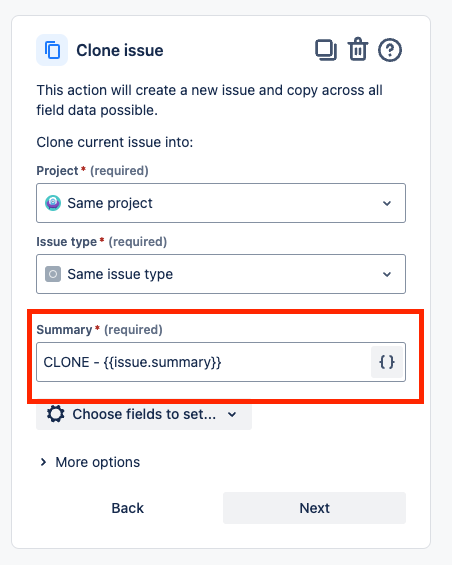

What are the details of the Clone Issue action in the below rule?
If you want to customize the Summary of the newly created issue you should be able to do that by modifying what appears in the Summary field in that action.
As shown, by default the Summary of the newly created issue will copy the summary of the source issue ( {{issue.summary}} ) and prefix that with CLONE -
You can change that field to change what text is placed in the Summary of the newly created issue.

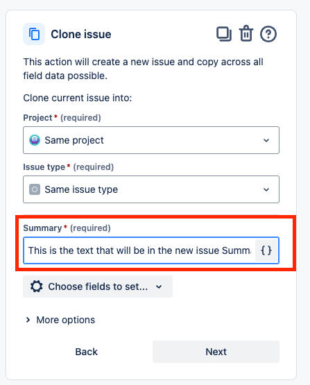

As an end user you have the opportunity to override that text when you execute the Clone Issue feature and before the cloning actually occurs.
Through the Automation rule you would change the text in the Summary field that I highlighted in with the red box in my previous response. Here is an example of the text having been changed in the Clone Issue action.

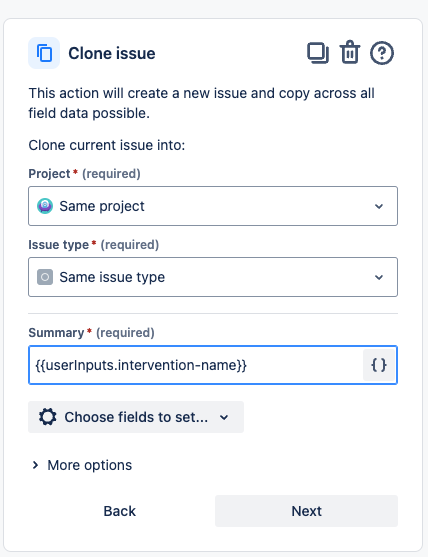

For your tasks and subtasks since you want the Summary of the source issue but not the CLONE - text, just delete the CLONE -  text from the field in the Clone Issue actions where you are creating the tasks and subtasks. Leave the field content as {{issue.summary}}
For the Epic, since you are prompting the user for the the new name of the Epic, use the smart value from the user input prompt to set the field.
