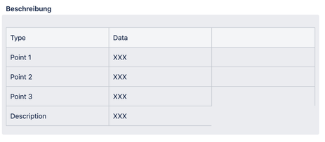

since using JIRA we used a table as layout for our CCM to give precise information. They created the issue with the following example code below. Since some weeks this creation of tables seems to be broken, because it adds a third column with broken format to a two column table. The table code is copied from this JIRA documentation: https://jira.atlassian.com/secure/WikiRendererHelpAction.jspa?section=tables
They example in the documentation is not working properly as well. Any idea how we can fix this?
Table layout we are using (sorry I don't know how to post a code block here :/):
||Type||Data||
|Point 1|XXX|
|Point 2|XXX|
|Point 3|XXX|
|Description|XXX|

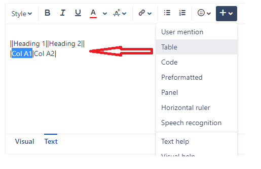

Hey,
the formatting in my post was broken, thanks for that. We don't have any line breaks between the lines - I tried your code as well but it creates an unnecessary, broken column :/ Any other ideas?

Hello,
thanks for answering so quick!
Below a screenshot of how the table looks.
We only use the table within the description field, therefore we never tried it in another field. I am not sure how it behaves there.
