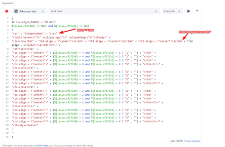

Hello,
I have a question. Does anyone have experience with JWT Calculated Textfield? I want to build a risk matrix  (4x4 Matrix) and have created an HTML code. However, it is not working. I am not getting a table structure. Can someone help me with this?"
Thanks in advance.
Leena

Hi @Leena Pratheepan ,
My name is Sergio, and I'm a member of the support team from Decadis.
I've noticed that there were a couple of things which had to be fixed from the expression you wrote in your message.
Before giving you the expression corrected, please take a look to this screenshot to have a better understanding of which parts were missing:
As it's mentioned in the screenshot, it seems that there was mising a "+" symbol and also closing the quotes in the lines 5 and 6 from your expression. Here you have the expression modified, now it should work as expected!

Could you please try using these expression and let me know if it worked?
