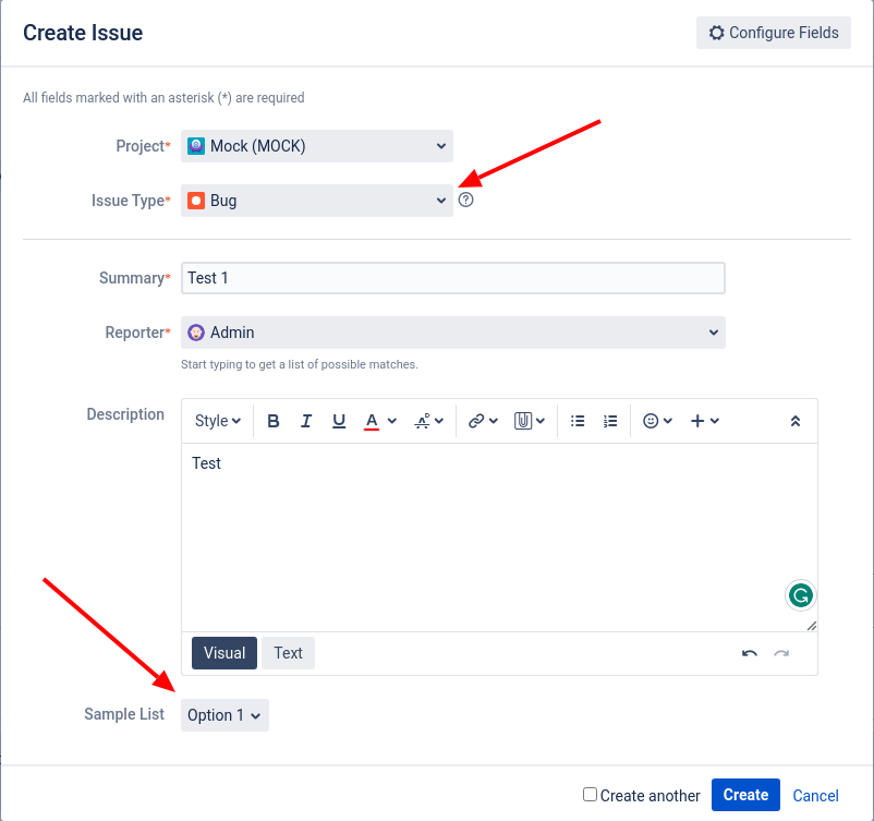

For the first test, I will test the Issue Created event.
1. First, I am creating a new Bug and setting the Sample List to Option 1, as shown in the screenshot below:-

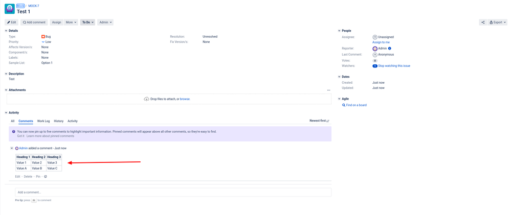

2. As expected, once the Issue is created, the Comment is also added, as shown in the screenshot below:-

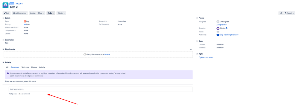

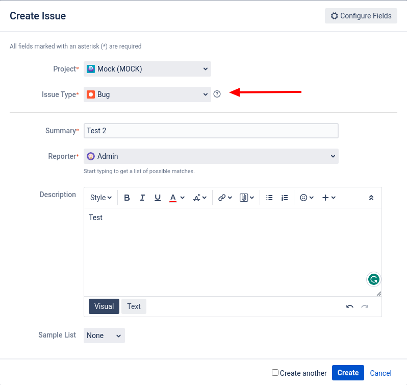

For the next test, I will test the Issue Updated Event.
1. First, I am going to create a new Bug, and I am not going to select any value from the Sample List as shown in the screenshot below:-test3.png
2. As expected, the Issue is created, and the Comment is not included, as shown in the screenshot below:-

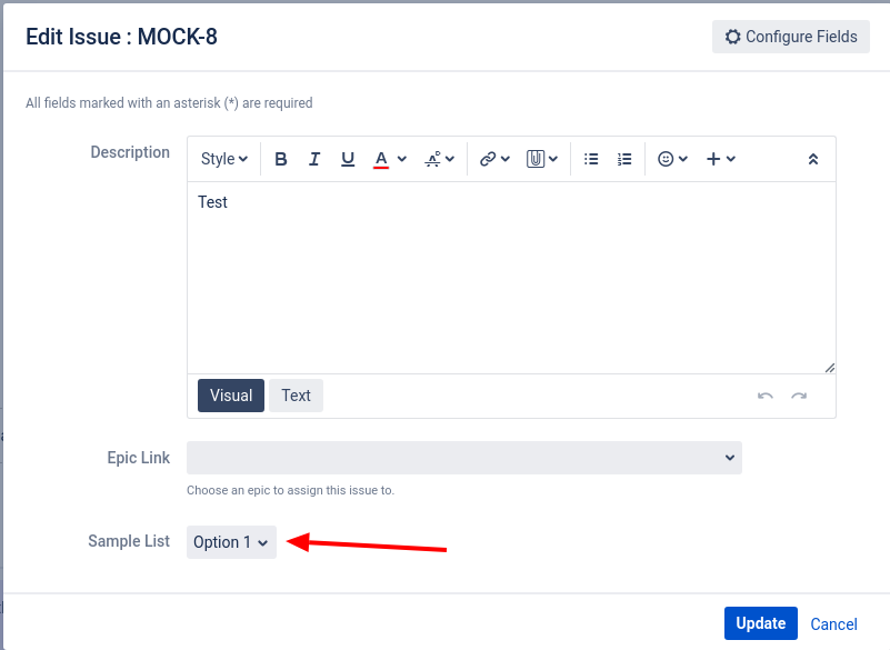

3. Next, I edit the Issue and  select Option 1 from the Sample List as shown in the screenshot below:-

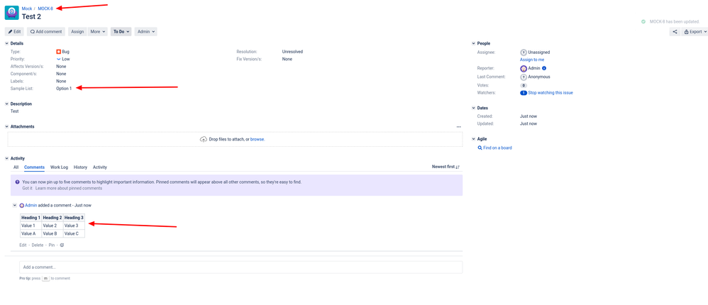

4. As expected, the Comment is added as shown in the screenshot below:-
