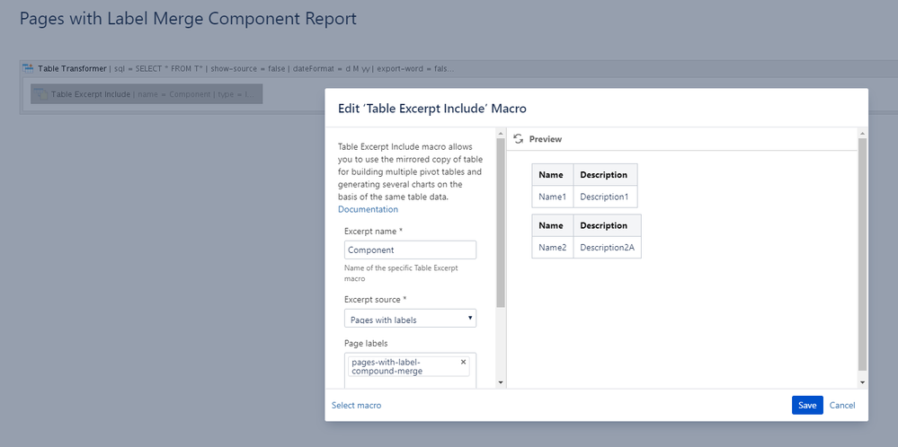

I am trying to merge tables brought in from a Table Excerpt Include macro with the 'pages with labels' option. In the preview, you can see two tables are being brought in (as expected):

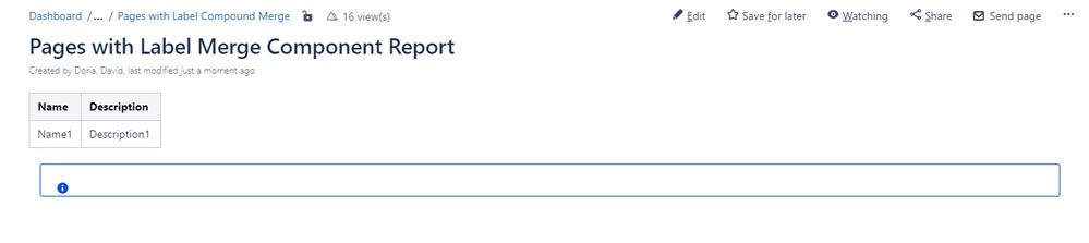

preview.pngHowever, with a very simple Table Transformer that I know works with these two tables, the output is strange (note the long blue box):

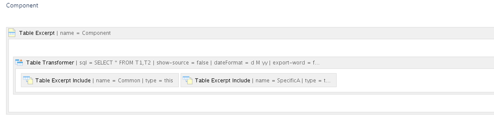

error.pngI have some potentially unusual things going on, where I am constructing the second table that is getting pulled in like this:
construction.pngIf I construct the table directly instead, the Table Transformer works fine.
I guess I wouldn't be shocked if this didn't work, but I'm confused because in the Preview the Table Excerpt Include looks like it did it's job, so I don't understand why this whole thing would fail.
