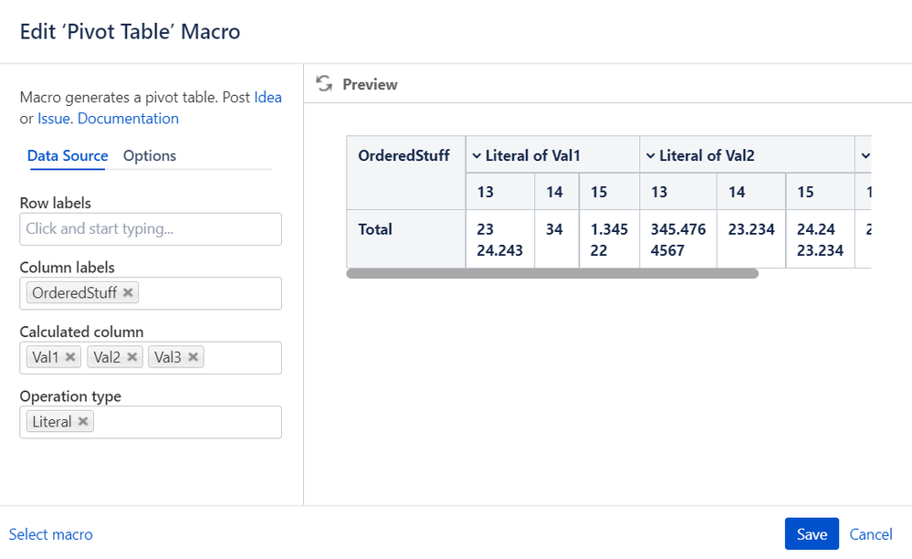

As for now you may also try to use the Pivot Table macro to aggregate your data:
If you are not sure how many ValX you have, then type in manually all the possible variants beforehand in the "Calculated column" section.
Hope this solution somehow helps.

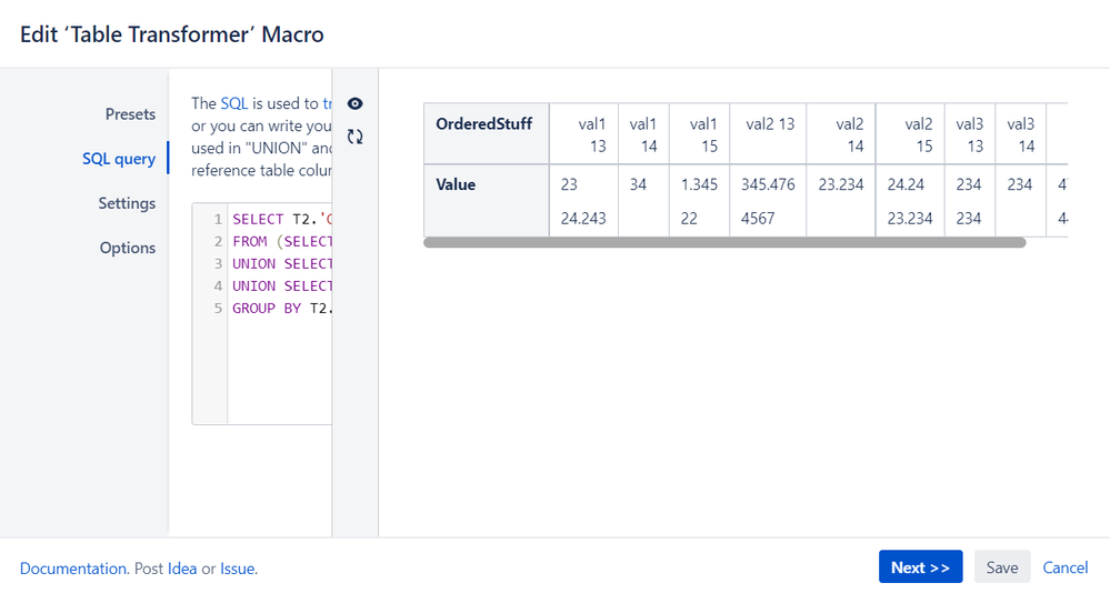

And you may also try the following SQL query instead of your original one:
SELECT T2.'OrderedStuff', CONCAT_VIEW_AGGR(FORMATWIKI(T2.'Value' + " \n")) AS 'Value'
FROM (SELECT ("val1 " + T1.'OrderedStuff') AS 'OrderedStuff', T1.'Val1' AS 'Value' FROM T1
UNION SELECT ("val2 " + T1.'OrderedStuff'), T1.'Val2' FROM T1
UNION SELECT ("val3 " + T1.'OrderedStuff'), T1.'Val3' FROM T1) AS T2
GROUP BY T2.'OrderedStuff' ORDER BY T2.'OrderedStuff'
It seems to be a little bit shorter, but the valX columns are still listed manually.
