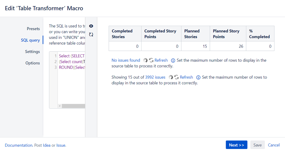

We've recreated your case and used your original query for the Table Transformer.

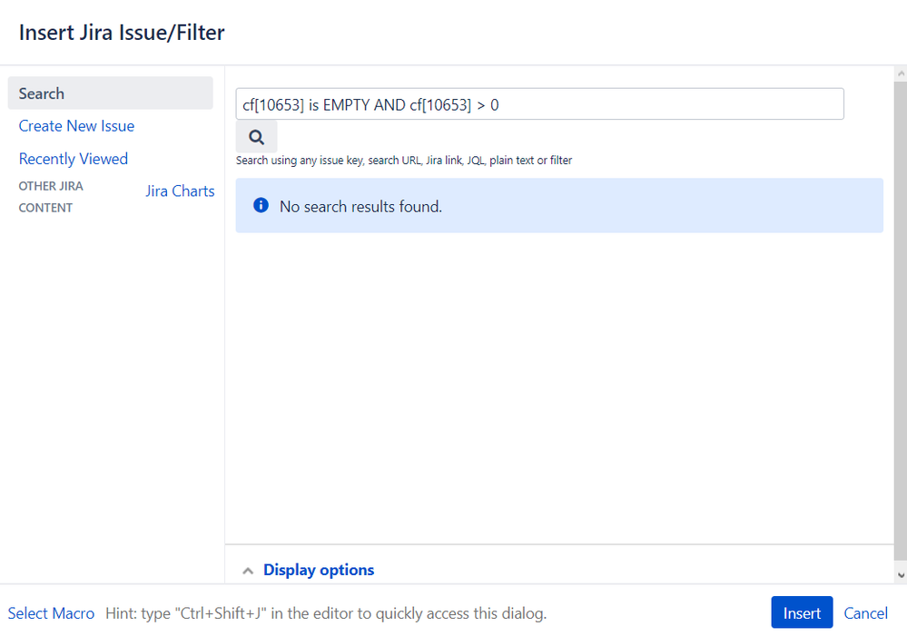

Jira 11.pngThe first Jira Issues macro: no filtered results, empty table
Jira 22.pngThe second Jira Issues macro: a table with results
Jira 33.pngThe preview of the Table Transformer macro
Jira 44.pngAs you can see, everything works just fine.
Maybe we don't get what is wrong with your empty table - please, clarify what do you exactly mean. Is something wrong with the permissions? Maybe you don't have access to some projects/issues and get errors with the Jira Issues macro?

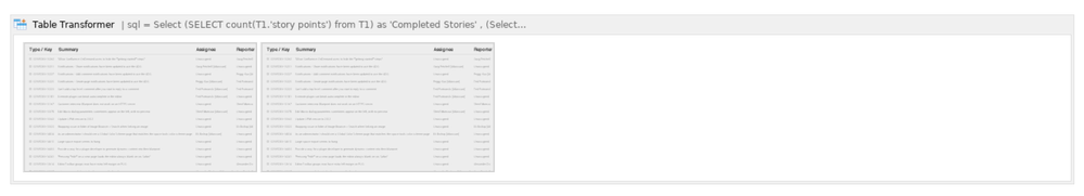

Thank you for the quick response. This is exactly what am doing. However, this is what I get in the final result as there are no rows in the second table

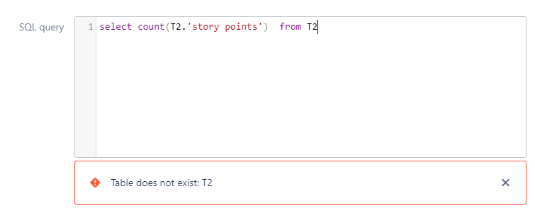

Just to validate, I changed the whole query and did the below select and have the same T2 error

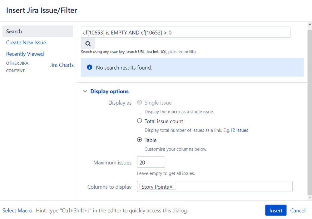

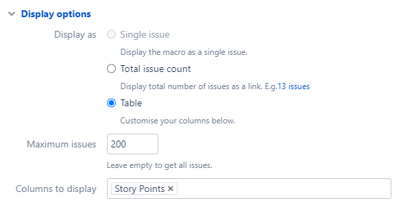

Is there some configuration am missing. When filtering via JIRA for each of the tables, the only field am selecting is story points. Is that right ? Is there anything else i need to select

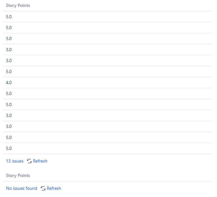

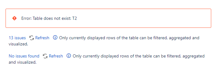

And how does your empty Jira table look without the Table Transformer?
It should be like this - your Story Points heading and an empty line. It seems that smth is wrong with the Jira Issue macro, the Table Transformer can't recognize it as a proper table (the screenshot below is taken from the view mode of my test page).Jira 55.png

And we also choose just the Story Points field to show in the Jira Issues macro configuration - so you're doing everything right:

Below is the screenshot of both the tables in view mode without the table transformer.
I think its behaving the same. Dont understand what's going wrong :(
