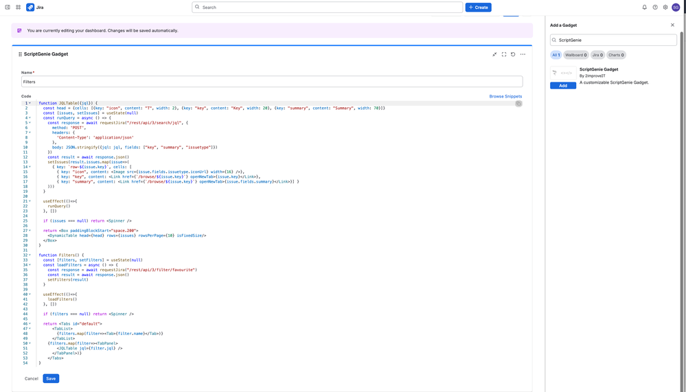

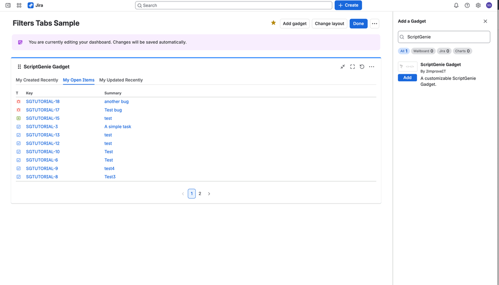

Another option is using ScriptGenie (full disclosure: I am the developer). You can script your own Dashboard UI (or other ui's). I have created a simple example showing favourite filters using tabs.

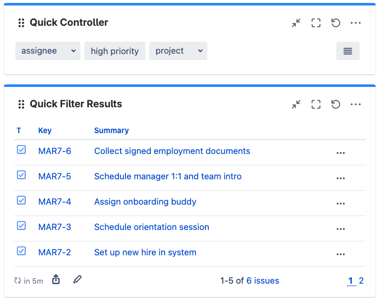

I’m Marlene, from the team who works on Quick Filters for Jira Dashboards, and I’d like to add another Marketplace app to the list of suggestions. :)
With Quick Filters for Jira Dashboards, you can add a Quick Controller gadget to your dashboard, which lets you dynamically filter all other Quick Gadgets on the dashboard—including the Quick Filter Results gadget.
Our app is lightweight and easy to set up. All configuration can be done directly on the dashboard, so there’s no need to switch back and forth between the dashboard and separate configuration pages.
We also support JQL in most configuration scenarios, giving users the flexibility to create anything from simple filters to more complex setups, depending on their needs.

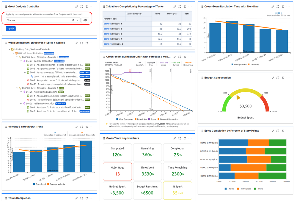

Jira does not provide such a tabular gadget out of the box. It also does not include a built-in controller gadget that can dynamically apply filters to other dashboard gadgets.
You may find Marketplace apps that offer this functionality. However, keep in mind that a controller gadget provided by a Marketplace app will typically be able to control only the gadgets from that same app, not Jira's native gadgets or gadgets from other apps. In practice, this allows you to simulate a multi-view or "multi-tab" dashboard, rather than a single gadget with multiple tabs.
If you're open to trying a Marketplace app, our Great Gadgets app includes a Great Gadgets Controller gadget that lets you save multiple filter queries and switch between them using a dropdown menu. When you select a filter, it is automatically applied to all other Great Gadgets on the same dashboard.
Hope this helps.

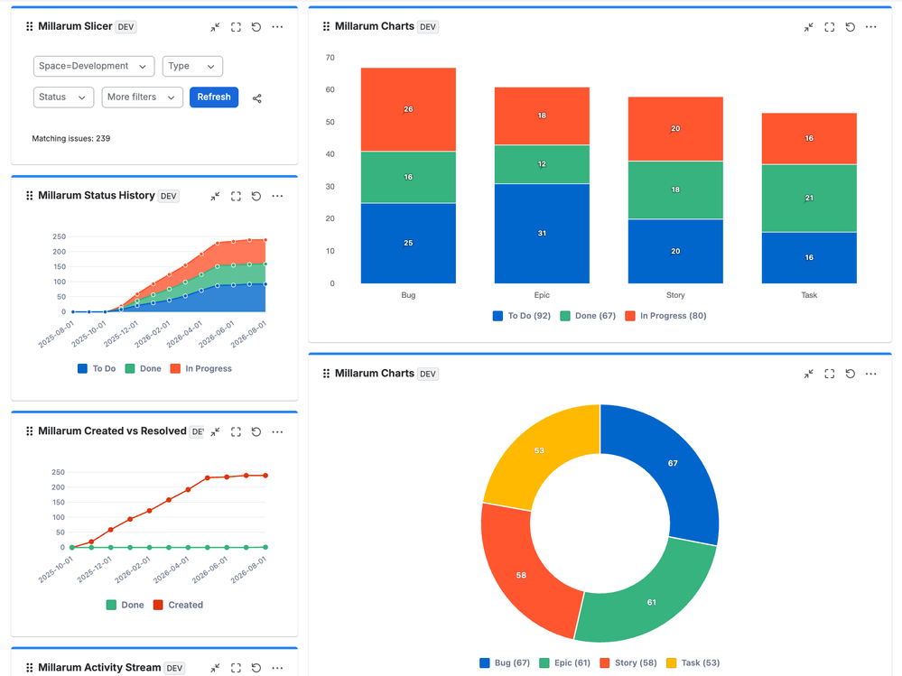

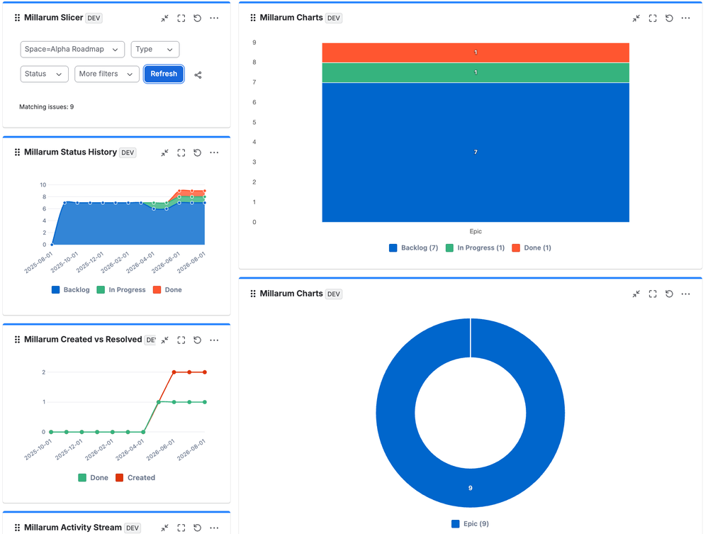

Hi @Mahmoud Farouk If you're open to 3rd party solutions, Millarum Dashboards support slicing the data for a dashboard dynamically and can be refreshed within seconds, also filters can be shared through URL's so the URL's can be bookmarked and you can keep jumping between your initiatives.
Here I share a quick view on how the same dashboard is configured and shows the content of 2 different spaces by changinf`g the controller on the top left.

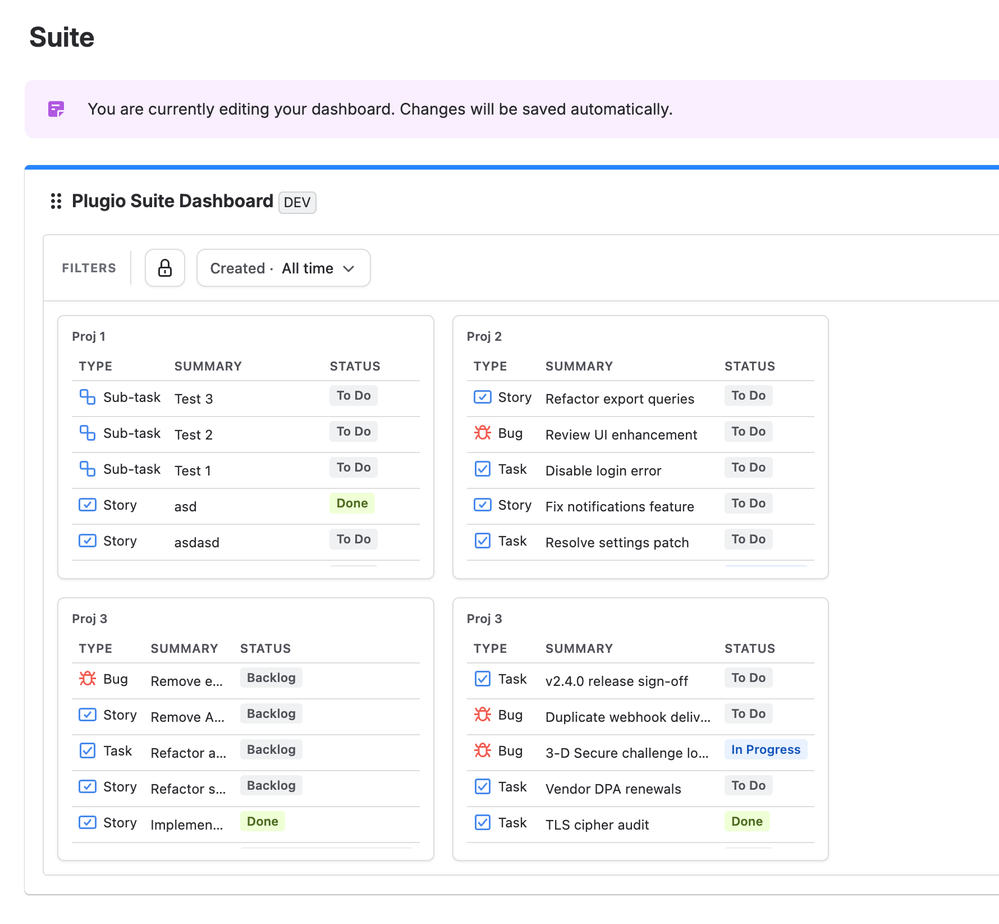

In the meantime — full disclosure, I'm the developer of Plugio Suite — it takes a different route to the same problem. It's a dashboard builder that embeds into a Jira dashboard as a single gadget (and also runs as a full page). For your case: five List widgets on one canvas — each with its own JQL  and its own column configuration — so Active / At Risk / Overdue / Missing Data / All all live in one gadget. Two things separate Filter Results gadgets can't do:
  • One shared filter bar: dashboard-level filters and the time window apply to all five lists at once — change it once, every view updates.
  • If you want the "At Risk (3)" style overview, count widgets can sit above the lists showing each view's number at a glance.
To be fair about the limitation: there are no tabs, the lists sit side by side — so it consolidates everything into one gadget with one filter bar, but it won't shrink it to 1/5 the space the way tabs would.
