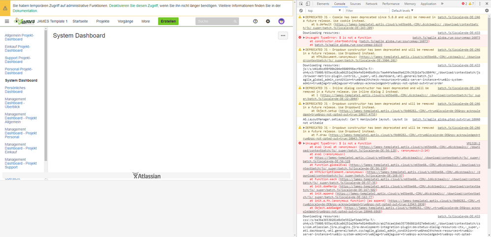

i just upgraded Jira and the system dashboard is now empty:
dashboard_broken.PNGI see neither failed HTTP Requests during load nor Exceptions in the Jira log.
Only the JS error is suspicious.

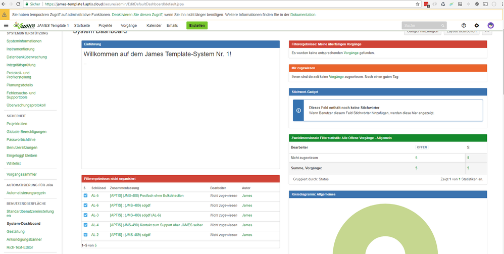

When i go to system > system dashboard with the same user and browser the dashboard display fine there.

There was a Javascript embedded in an HTML element on the dashboard that expected "$" to be a reference to Jquery.
In Jira 7.5.3 that does not be the case any more,
it could be fixed by replacing $ with AJS.$ in the JS code

And, as mentioned already: There are Javascript errors (see first screenshot)
Jens Kisters __SeibertSolutions
December 7, 2017
In safe mode the dashboard shows again, im gonna enable addons one by one to see when it stops working
