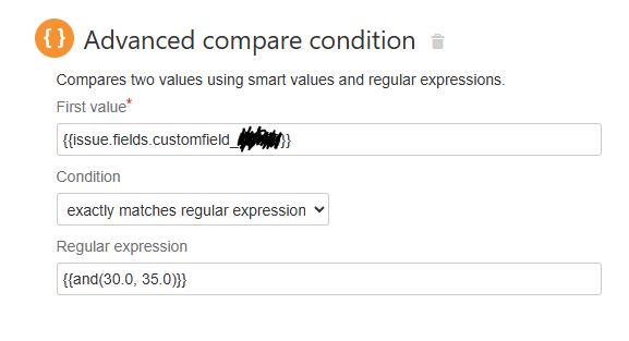

Dear ALL,
where can I find the syntax to be used in "advanced compare condition" where the condition is that the value of a smart value (in my case a number) is between 2 values?
I have tried the following but it doesn't work:
Thanks, Vincenzo.

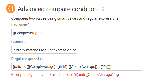

vincenzo.spatafora
June 2, 2025
Hi @Bill Sheboy
nice to read you again out.
Do you mean like this? (I get a parsing error):
What is wrong?
Thanks in advance, Vincenzo.
Bill Sheboy
June 2, 2025
When already inside an expression with double-curly brackets, please do not add more.
Assuming your field is a number you could try this:
  • advanced compare condition:
    • first value: {{#if(and(issue.ComplAverage.gt(45), issue.ComplAverage.lt(50)))}}true{{/}}
    • condition: equals
    • second value: true
vincenzo.spatafora
June 3, 2025
Thanks a lot @Bill Sheboy.
I see: I understand then you can not pass the smart value I have defined (ComplAverage); you got to pass the original issue (issue.fields.customfield_29300).
If so, something to be improved here.
Thanks again, Vincenzo.
Bill Sheboy
June 3, 2025
Just so I understand...were you using a Created Variable rather than the field directly?
If so, that explains the problem: Data Center's automation rules do not have the asNumber function yet (but Cloud does).  With that function, you could have used ComplAverage.asNumber and it would have worked.
