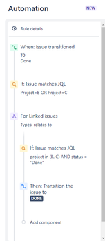

I am trying to sync the status of linked issues. However, there is a scenario which I can't avoid to sync the wrong issue. Following is the scenario
  • The Scope setting is All projects.
  • There are three projects.
    • Project A
    • Project B
    • Project C
  • There are four issues and all issue types are Task.
    • A-1 (Project A)
    • A-2 (Project A)
    • B-1 (Project B)
    • C-1 (Project C)
      • A-1 is the main issue which include all information
      • A-2, B-1 and C-1 all [relates to] A-1
Following is the steps
  1. When B-1 or C-1 transition the status to Done
  2. Check if C-1 and B-1 status are both Done. if not, do nothing.
    if yes, transition A-1 status to Done but A-2 should not transition to Done
Currently, I can't avoid A-2 transition to Done in this scenario. Does anyone know what condition I should put after this automation triggered. Please give me your input.
Thank you

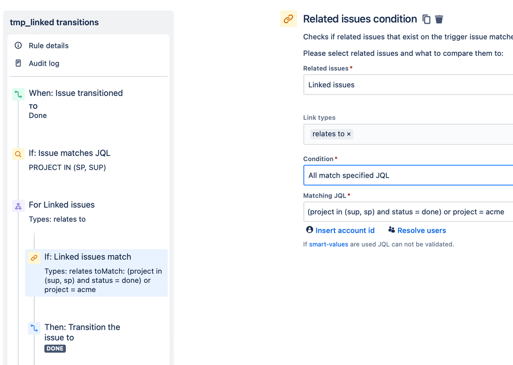

Paul O
June 3, 2023
You could try using a related issues condition as shown below.  For your project A, I've used project ACME and for projects B & C, I've used SP and SUP.
This seems to produce the desired results.
Trudy Claspill
June 1, 2023
Hello @[deleted]
Is there a relates to link between A-2 and the issue (B-1 or C-1) that transitioned to Done?
Your Branch is looking at the issues linked to the trigger issue (B-1 or C-1) by the relates to link.
It is then checking if that linked issue matches the JQL project in (B, C) and status = Done. That is not a check confirming that the B-1 and C-1 issues are in a Status of Done.
If the linked issue (linked to the trigger issue B-1 or C-1 by the relates to  link) matches the JQL (in project B or C and already set to a status of Done) then it will transition the linked issue to the status of Done.
So, I'm not sure how this rule could be changing the status of issue A-2.
Can you provide the rule's Audit Log details for the execution that changed the status of A-2 to Done?
Deleted user
June 1, 2023
Hello @Trudy Claspill,
Thank you for your reply.
->No, Only B-1 or C-1 transitioned to Done will trigger this automation
-> if so, what JQL I should put after branch relates to if I'd like to check both linked issues of project B and project C are both in a status of  Done.
Thank you
