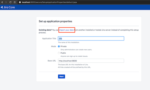

However in this process, if you are not actually upgrading Jira to a newer version, there is no need to apply a new license key here.   Instead, when you start up Jira connected to a new empty database, the setup wizard will launch.   That is likely where you are being prompted for a license key, but if you selected the 'Import existing data' option,

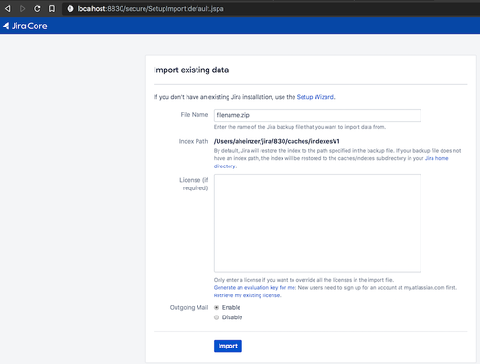

then you can reference the .zip file that contains your XML backup.  These are auto generated in your $JIRAHOME/export/ folder, but you are expected to copy the file you want to use here into the $JIRAHOME/import/ folder and then select that filename.zip on that next page:
You would only need to apply a new license on this page, IF you were upgrading the version of Jira AND the license contained in your backup was expired before the release date of this newer Jira version.
