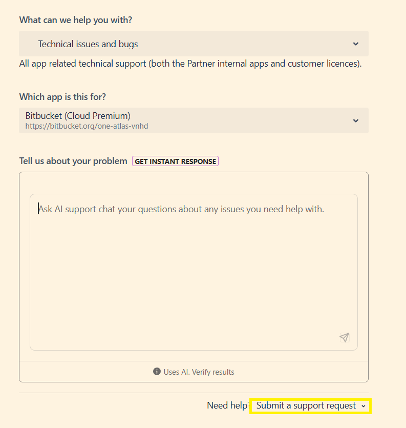

@Akash Singh , I tried raising a support request with Atlassian but the AI chatbot will just reply with the some reference link and not actually submitting the ticket. Is there another option to submit a request that will be routed to the actual support team or person?
@Joel Francisco You can avoid talking to the chatbot and submit a ticket directly by clicking on the link given at the bottom of the page, see screenshot.
