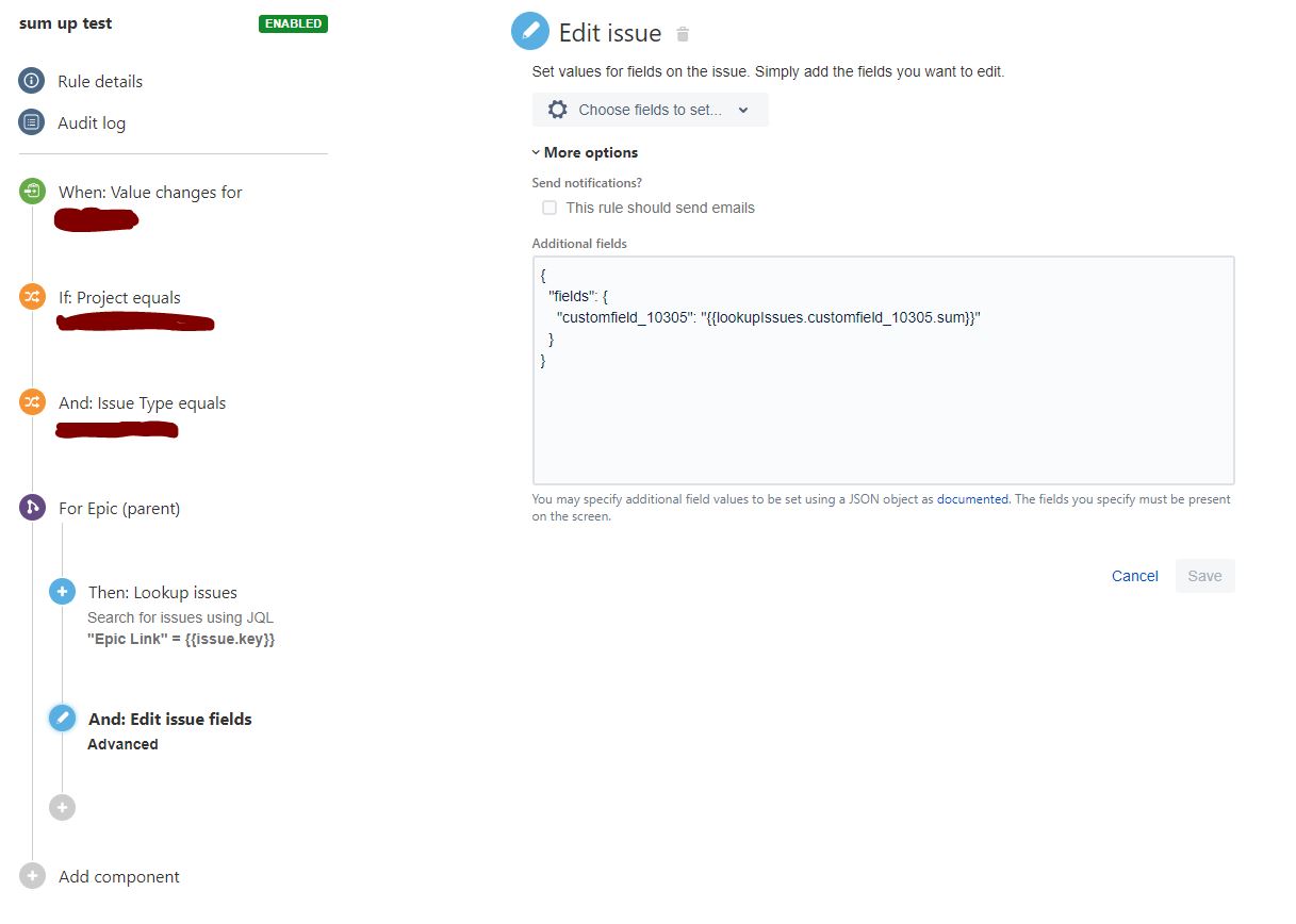

Hi,
I'm trying to use the method shown in the image below with the help of "Automation for Jira" to sum up the values of a numeric custom field (for example customfield_11035) in tasks and display the total in their respective epics (parent). the automation executes correctly, but it consistently returns 0 (zero) as the result within my epics.
Do you have any suggestions on how to fix this issue?

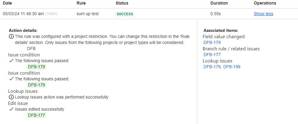

2. Audit log
If you have a better method for doing this task, I would be happy if you could suggest it to me.

Regarding the limitation of the lookup issue in automation that you mentioned, I think it may not be the cause of the problem in my case. The lookup action appears to be executed correctly, as indicated in the second picture I uploaded. The audit log confirms its success in finding the relevant child issues.
However, the issue arises in the subsequent step when the field edit action should be performed. Unfortunately, it fails to calculate correctly, consistently resulting in 0. As a test, I manually set the field value in the Epic (parent) to 40 and after triggering the automation with a new value in the tasks under that Epic, the value reverts from 40 to 0 again.
This leads me to suspect that there might be a problem in the final stage of the automation process. I would greatly appreciate any suggestions or guidance you may have.
