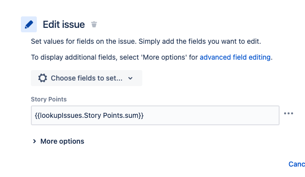

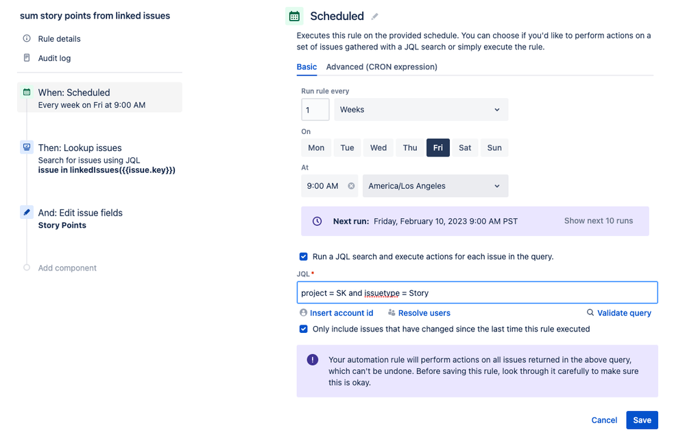

You could use a Scheduled task to select all the issues in Board B and then execute these actions:
There are other ways the calculation could be triggered.

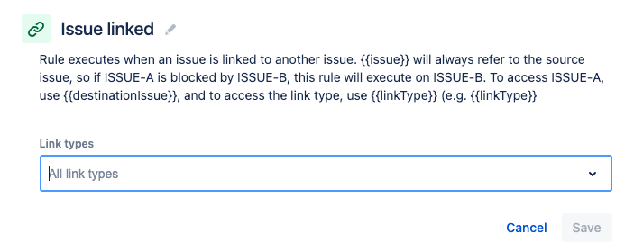

There is a Link Created trigger that will detect when an issue link is added, but it is more complicated to use. You have to understand which issue in the linkage is considered the "source" issue and which is considered the "destination" issue to figure out the next steps.
Which issue is the source and which is the destination is based on which side of the link relationship each issue gets. The source issue gets the Outward Description, and the destination issue gets the Inward Description for the link.
As noted in the trigger description, the source issue is the one that fires the trigger, regardless of which Board the issue is displayed in.
Rules are set to run against Projects, not Boards. So the triggering of the rule will depend on whether it is set to run against the Projects that contain the issues for these boards, and which issue gets the Outward Description of the link. Your rule would have to accurately determine which issue in the pair gets the story point roll up. If you always use the same type of link and the link goes the same direction (based on the Projects of the issues, not the boards), that would be less complicated than the use of multiple types of links with different directions. If the issues in the two boards are also in different projects (versus the same project) that can help make the rule construction easier. If the link relationship used is "relates" that makes things harder because the Inward and Outward descriptions are identical.

ACTION: Edit Issue
- setting the appropriate issue field in the Project A issue to the smart value {{lookupIssues.<your story point field name>.sum}}
