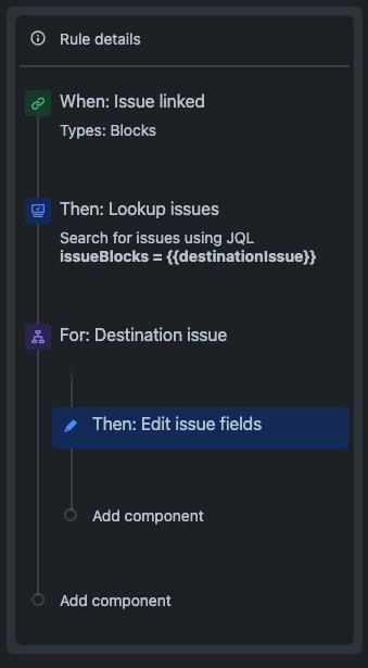

1 last question. in the solution you suggested, you used the setup here below.
Any chance you can show me how it should look? Im having issues setting it up.
BRANCH (Destination Issue)
      ACTION: Edit Issue (Total Cost)
             {{lookupIssues.Story Points.Sum}}
Mark Segall
August 15, 2023
Sure - Here's a screenshot:
Specifically, for the branch component, you'd select Branch rule/related issues and then select Destination Issue from the dropdown.
ori gal
August 15, 2023
it worked great. thank you!
