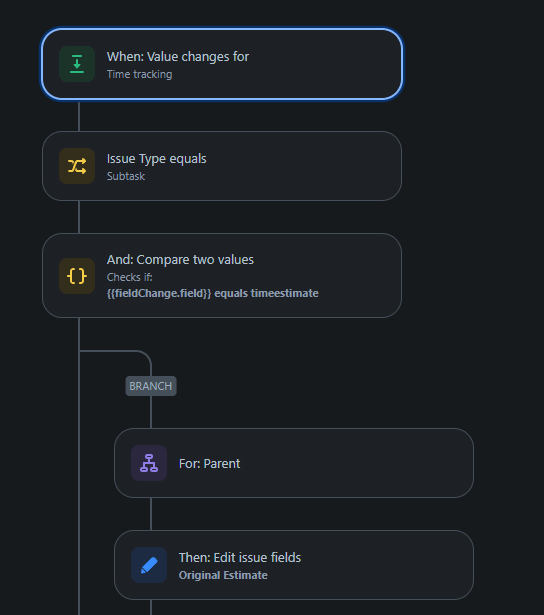

×Upon further investigation, I found that the steps I originally posted has incorrect value, and the correct value is timeestimate on step #3.

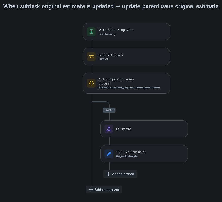

Here are the steps:
{{#=}} {{issue.subtasks.original estimate.sum}} / 3600 {{/}}
This also solved the problem I mentioned on bullet #2 in the answer section below. So now, even newly created Sub-task with original estimate field 0m then update it to any value will also successfully pass through. Original Estimate: 0m → 1h
I also want to add that, when you create a new Sub-task with initial Original Estimate: 0m then update it to any value. For example: 0m → 1h, there will be no action performed also. I do not know why changing from initial 0m → 1h is not counted as a change.

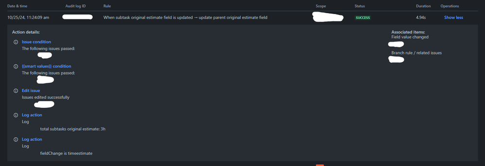

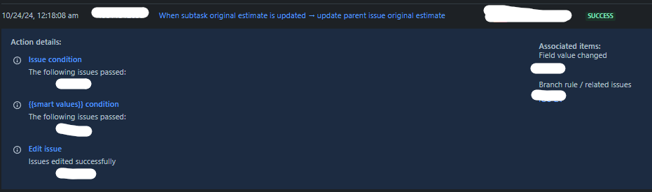

Here is the Audit Log that it is successful:
After spending 3 hours researching and tweaking automation rule. I wanna share this info to everyone. This post is likely not a question but a workaround solution to a common problem. Hoping this would help them save time and newbies like me in the future or my future self also ;).
My specific use case:
Here are the steps:
Note:
For I don't know reason, Original Estimate is not available as the trigger in Field Value Changed. So I have to use a workaround solution, I use the Time Tracking field to monitor for changes. Then I set 2 conditions to match only Subtask issue type and Original Estimate is changed.

Here is the proof that it is working in the Audit Log:
