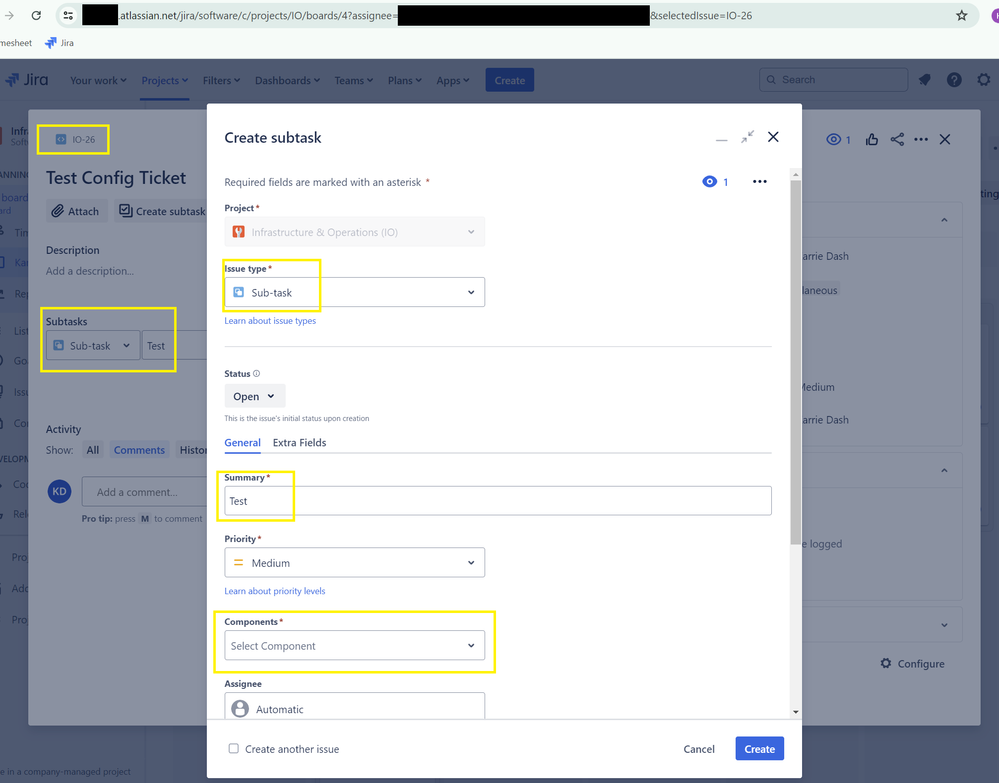

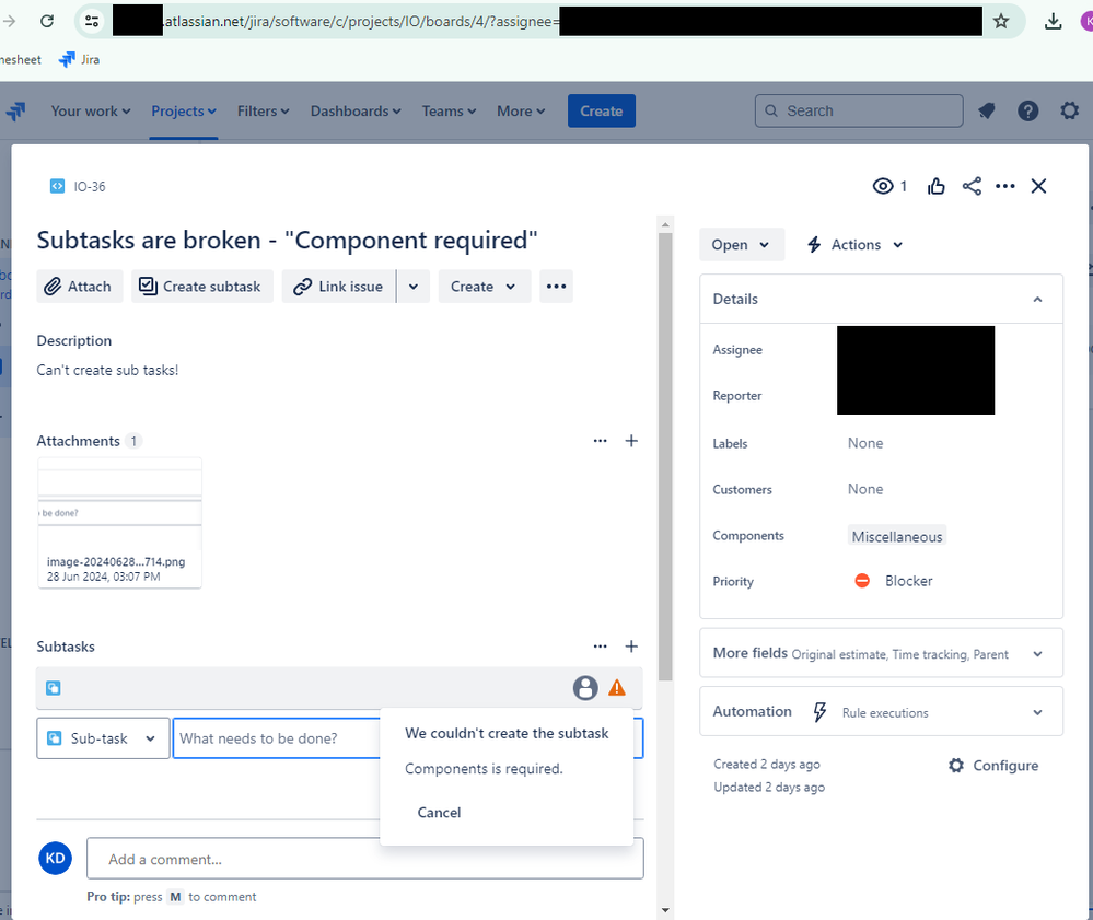

When creating a subtask while viewing the issue in a pop-up module the following error message sometimes appears after I type the task name and click on CREATE.
This does not happen for all tickets. Only some tickets, even if they are the same issue type.
Example: Viewing the parent task from a board.
When It Works

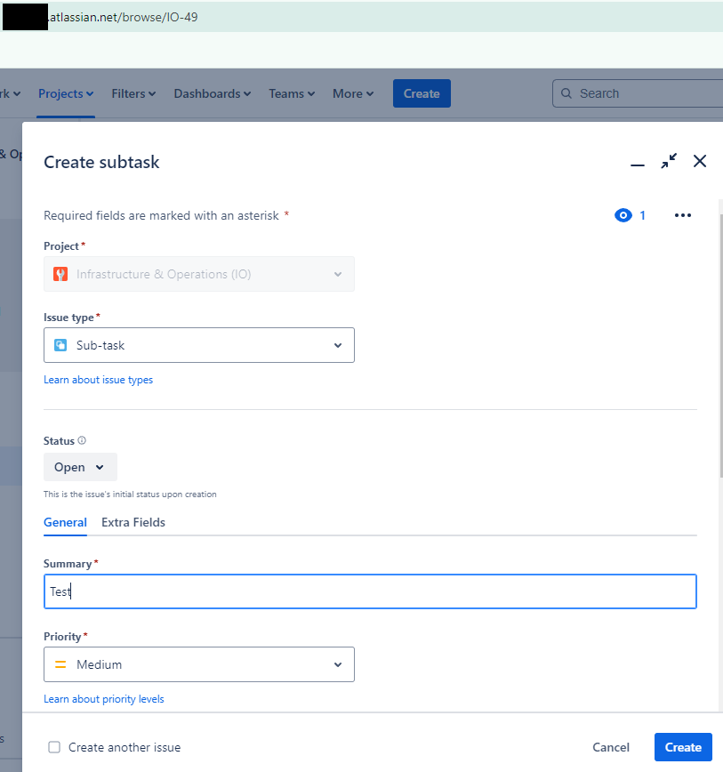

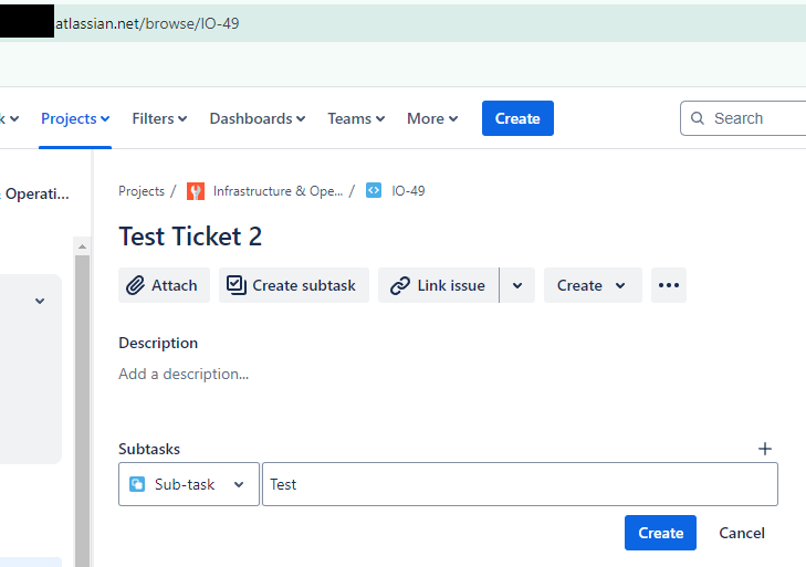

If I go directly to the ticket link (ex: https://XYZ.atlassian.net/browse/IO-36), I can create a sub-task ticket.
When I enter a ticket name and click on CREATE, the Create Issue screen appears (as expected)

This error is displayed when the component field is made required in field configuration that is configured to the project. The Jira admins needs to update the field configuration and make component field as Optional
Karrie Dash
June 30, 2024
Except that I can create a sub-task as expected within the ticket if I go directly to the ticket link. This error sometimes occur when I have the ticket open as a pop-up module.

When you open the issue from the project board, a pop-up window for the parent issue is created. If the subtask requires a component, you need to open the issue creation screen to fill in that field.
However, because you already have a pop-up open for the parent issue, it's not possible to have a second pop-up open for the subtask creation screen.
For that reason, you see the warning message, and the issue is not created.
The workaround, as you've already mentioned, is to go to the parent issue in order to have the pop-up for the subtask creation screen.
I hope this clarifies your question.
