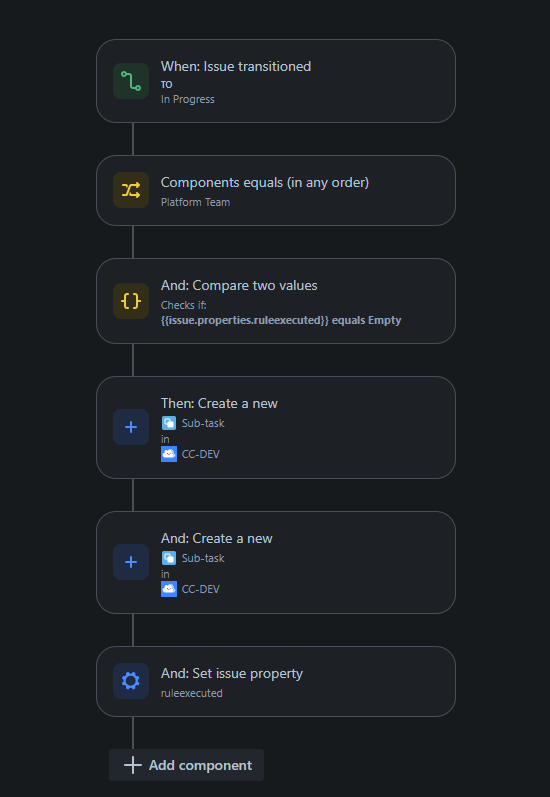

HI all,
I've created an automation where when an issue hits 'in progress' status, two subtasks are automatically created
I am trying to trigger or create a separate automation for when an issue (same issue) hits the 'ready for QA' status, three different subtasks will be created.
The problem I am having is, the 2nd rule (ready for QA) isn't executing, because of the 'issues.properies.ruleexecuted' component I have set in the 1st rule (in progress).
I added this step in case the issue goes back into 'in progress', so the subtasks won't regenerate causing duplicates.
Is there another way around this?
Thank you for your help!!!

Hi @Kerri-Anne Mak ,
Just for my clarification, does the "issue.properies.ruleexecuted equals Empty" condition exist in the second rule also, and that is why it does not get executed?
If so the simplest solution would be to use different properties for the different rules. e.g., in the "in progress" rule, you can read and set "issue.properties.inprogressexecuted", and in the "ready for qa" rule you can read and set "issue.properties.qaexecuted", and so on and so forth for other states (if you need them).
Hope that helps!
Kerri-Anne Mak
March 1, 2024
Hi @Hariharan Iyer
This worked!
Thank you for your help.
I had originally set the condition in both rules, but didn't set different properties. I have now adjusted to your suggestion and it works.
Thank you again.

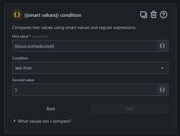

mruttan
March 1, 2024
A simple method to achieve this would be to count the number or subtasks on an issue before creating.  If you add a "proceed if less than 2 subtask condition" to the rule shown above, your automation will not complete.  I am using this method for a similar use-case and it is working well.
