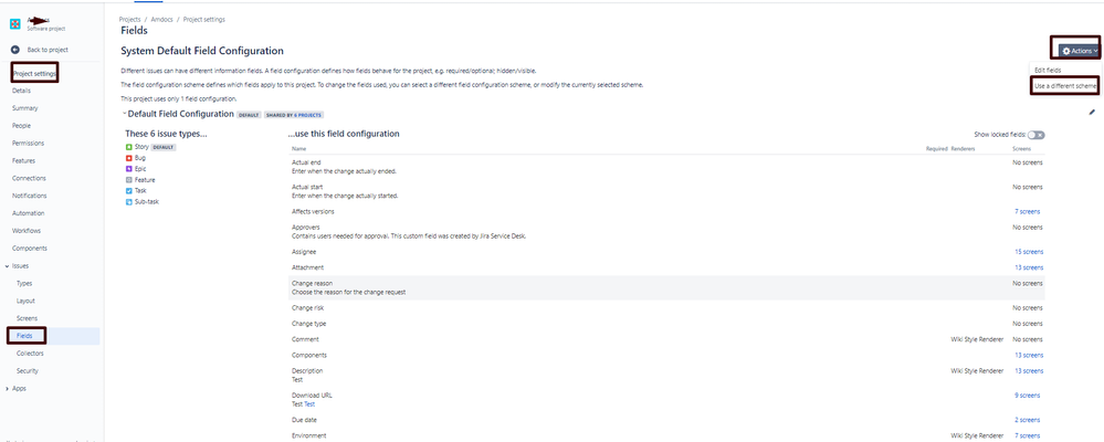

As per image you have created Field configuration scheme - EngineRoom Scheme
Now you need to associate this Scheme to Project
1. Go to the Project Setting to which you want to associate this scheme
2. There Select Fields.
3. On Right hand side > Action? use different scheme
4. There you can select EngineRoom Scheme
Accept the answer if it helps

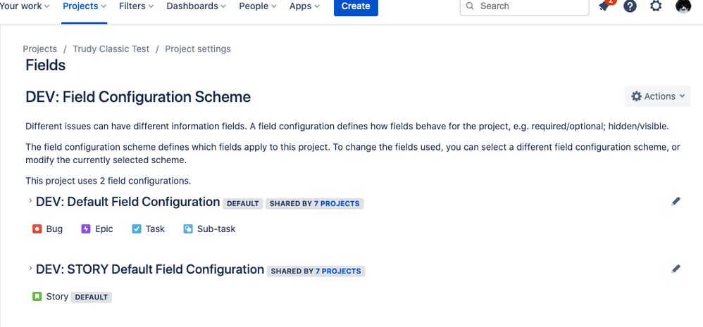

I'm assuming you are working with a Company Managed project.
In that case, the project already has a Field Configuration Scheme associated to it.

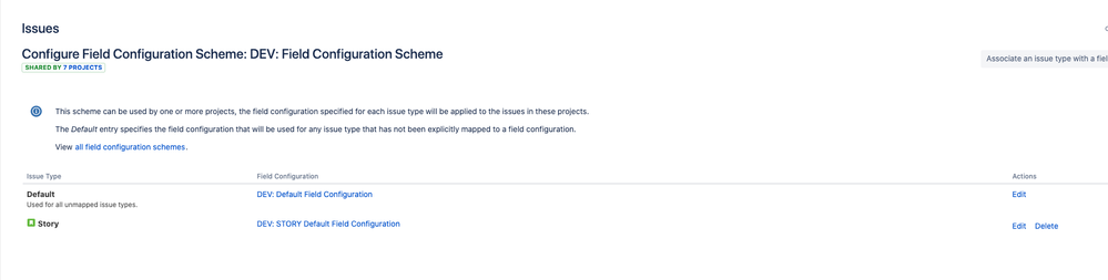

In the Field Configuration Scheme issue types are associated to Field Configurations.
In the below image, the issue type Story uses the "DEV STORY Default Field configuration" and all other issue types (in projects that use this Scheme) will use the "DEV Default Field Configuration"
You need to add your Subtask Field Configuration to the Field Configuration Scheme associated to the project, and within that Field Configuration Scheme associate your Subtask Field Configuration to the Subtask issue type
