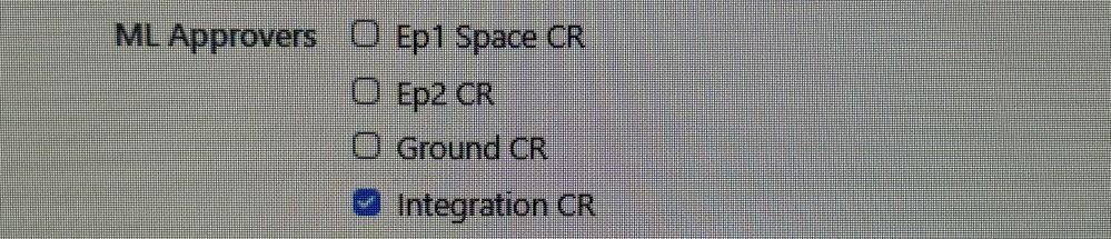

I have a radio button custom field as 'ML Approvers' that has four options (Ep1 Space CR, Ep2 CR, Ground CR, Integration CR). The value 'Integration CR' is the default value for the custom field so it is already preselected.
Based on the ML Approvers selection, a subtask is created for each value that is selection i.e., if Integration CR is selected then a sub-task is created and linked to the parent ticket.

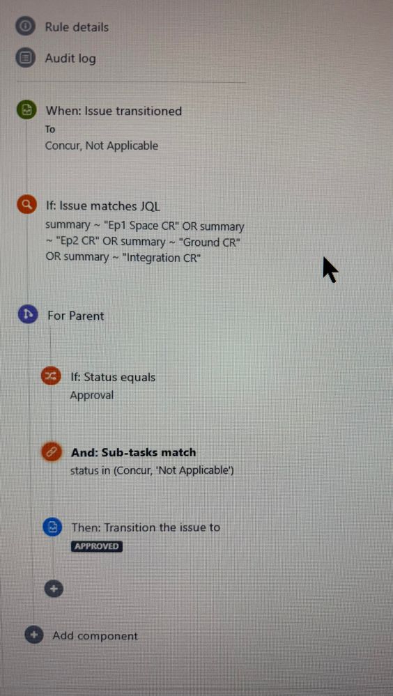

I built out an automation rule that checks that each sub-task is in the status 'Concur', or 'Not Applicable' which should then move the parent ticket to the status 'Approved'.
However, once the 'Integration CR' was set as a default value. It broke the automation rule and is no longer executing properly. Can someone please assist in how I can modify the workflow to have it run as it is intended. I have included screenshots for reference.
Custom field:
Automation Rule:

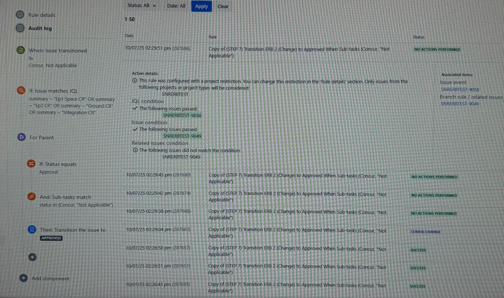

The audit log keeps saying that the 'Related issues condition' did not match the issue. So not sure what keeps on preventing the automation from executing the intended rules.

John Funk
July 10, 2025
HI Mahnoor - Welcome to the Atlassian Community!
That tells me the parent status is not equal to Approval at that point. You can log the current value out to see if you want, but that's the error message to me.

@John Funk -- I believe the log now shows the Parent matching and the Subtasks not matching the JQL.  Perhaps one of the earlier post's edits showed it the other way?
@Mahnoor Arshad -- without seeing image for the condition I asked about...
First, you seem to be using Jira Server or Data Center.  Is that correct?
Next, it appears you are using the "All match specified JQL" option.  In my experience, the related issues condition (particularly with JQL) can have some odd behaviors
With your current rule, let's verify what is happening by adding a write to the audit log with the Log action, inside the branch and before Subtasks check:
subtasks: {{#issue.subtasks}}{{key}}:{{status.name}}; {{/}}
This should list the subtasks with their status names, helping to verify your assumptions.
FYI -- Because of the occasional odd behaviors I described with that condition type, a workaround is to not use it, and instead use the Lookup Issues action and a Advanced Compare Condition.  For example, the JQL can be inverted to check for the absence of other issue status values:
  • Branch: to parent
    • Issue Fields Condition: status equals Approval
    • action: Lookup Issues, with JQL to check for issues not in the desired status
      • parent = {{issue.key}} AND status NOT IN ("Concur", "Not Applicable")
    • Advanced Compare Condition:
      • first value: {{lookupIssues.size}}
      • condition: equals
      • second value: 0
    • action: Transition Issue to Approved
