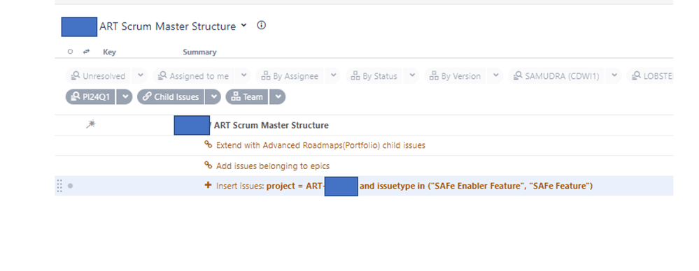

I have a structure that I built by selecting all Features from a specific project and extending it with the features Child issues. In my company we follow the (Epics- Capabilities- Features- Stories) hierarchy and each of those levels is its separate project.

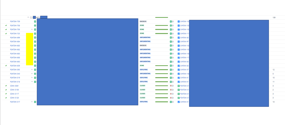

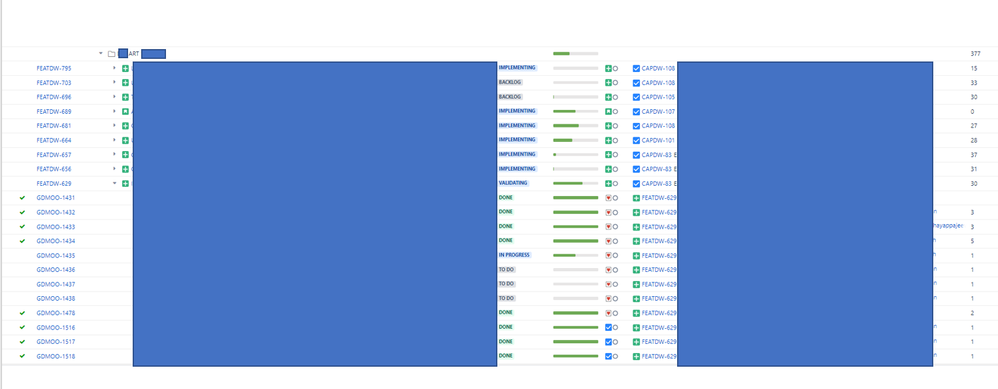

The Child issues got imported, however not for all Features. One project is missing and I cannot figure out why. I want all the stories to be visible like on the second picture but you see on the third picture, I have a lot of Features that have stories under them but they don's how up. Those stories are not in the CDWI project but a different one.
Can it be because we recently migrated to the new project? Can this be somehow fixed?Structure set up.PNGCorrectly working part.PNGIncorrectly working part.PNG

1. Missing Stories of Features are indeed linked to them with the Parent link. If they don't or if they have a different type of a link, then you should add a relevant Extend generator for adding issues with this link to the structure.
2. The Stories' project is added to the 'Projects with Structure' list at Administration | Structure | Configuration. If a project is not included on that list, it will not be possible to add any issue from it to any structure.

Hello! Sorry it took me so long- it was a configuration issue, the projects needed to be added to the 'Projects with Structure' list as you suggested.
