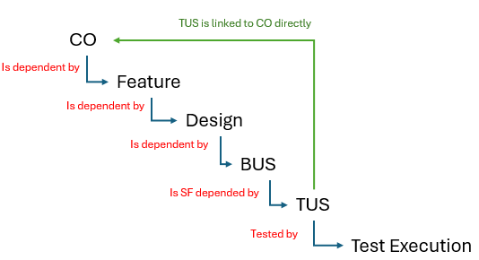

Let me start by showing you the relationships and issue types as they are defined in JIRA:
So basically I need to build a structure that needs to go 6 levels down, but the problem is that I NEED TO FILTER OUT any linkage where the TUS is not also linked directly with the CO through relationship "tests". In other words: I have HUGE performance issues because I need to load all the content (we're talking 1000's of lines), and only at level 5 can filter out through a formula like "CO_Link"

I dabbled in S-JQL by using a "child of root" filter (as the TUS is linked directly to the CO), but this failed to work, as it only considers hierarchy levels in the structure, and doesn't seem to work when it's 5 levels deep. If I use "descendant of root", I keep getting the TUS I don't need, as they are indeed all descendants, but just not directly linked through the green arrow in my screenshot...
