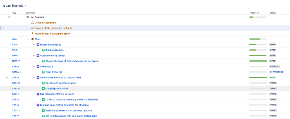

I think you want to see something like this? (I used two, nested groupers in this case. First to group everything stories (child) by their epic (parent) is the appropriate parent/child link.
As I said above, your use case may require a different approach. If this (below) doesn't work please contact us via structure@almworks.com
@Dave Rosenlund _Trundl_ This was helpful! Now my only issue is that I'm getting duplicate issues in a category that says "No Links" for those issues that are a parent issue, but don't have a parent issue. :)
The remove duplicate extender doesn't work on the level they are at. Thoughts on if it's possible to remove the dupes? Thanks for your help!

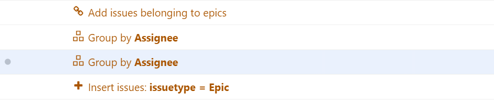

Hi @Laci You can do it by adding 2 group generator based on Assignee. Top or First Assignee group at Current Level and Second Assignee group at 2 level.
Thanks
