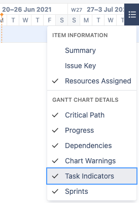

Hi Team
The solid bars at the beginning and end of each task are a good enough indicators of the the fact that its a fixed duration task and hence i want to get rid of the pin icon highlighted in yellow below from the gantt chart. Is this achievable ?pin.PNG

Hello Manali!
This is Alexey from ALM Works,
there is an option to hide all indicator icons:
Please, note that turning Task Indicators off will also hide other icons like Agile Mode, etc.

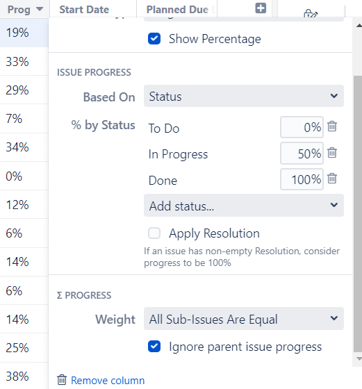

I am trying to get the gantt chart to use a formula field ('Progress' in pic below) for progress calculation. Even though it mentions here that I can use any other field apart from work estimate the options are limited. How can I achieve this ?
'Progress' formula field is based on Status and ignores parent issue + no 'Apply Resolution'
