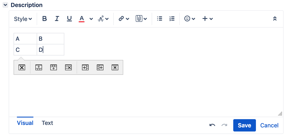

I am trying to insert a table from an Outlook email looking like this:
When I select the table and paste it in the Description field in a Jira issue it looks fine at first:
image.pngBut when I click 'Save', it turns into:

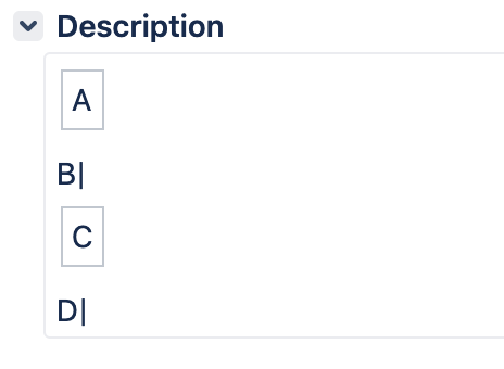

So, cell A and C are turned into tables of their own, while B and D are formatted Wiki-style. Editing again and changing into Text mode gives:
|A|
B|
|C|
D|
And finally: When I insert a table (using the editor) in the Description field while in Visual mode, I get the same result as pasting the table from the Outlook email. But when I insert the table in Text mode, it works as expected.

I’ll suggest you paste in text view as this shows you clearly why it’s broken.
When it comes to pasting from other text editors, I cannot recommend using the Visual view.

You can then use ‘|’ between each character to create your table.
For some reason when you paste, the visual view is not recognizing the pipe after B and hence seeing the input not as a table.
Edit one of your old settings with the problem and switch to text.
Also consider removing white spaces.
