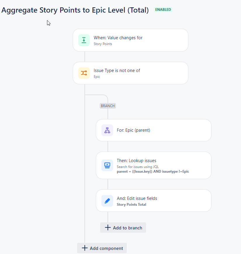

we have two issues related to story points calculation:
1. some updates on EPICs on child issue level are not getting recognized. Summarizing, story points calkucaltion is not working as we expected. When I go to the epic and update story point manualy (on child level), total story point on epic get good digits. That is the reason why I want to set up daily updates - to make sure that all story point have beed recalculated.
2. when I delete child issue, total story points on Epic remains the same.
This is my automation rule:
Bill Sheboy
January 11, 2024
Thanks for that additional information.
Are you using a Company-managed or Team-managed project?  You may find this information at the lower-left side of the screen expanding area.  This is relevant as Company-managed projects use the "Story points" field for rules and Team-managed use the "Story point estimate" field.
Next, you noted that "some updates on EPICs on child issue level are not getting recognized."  Under what conditions / changes are the values not updated by the rule.
Finally, you noted "when I delete child issue, total story points on Epic remains the same."  The rule you show is triggered on a change to the story points field, and not to other changes, such as adding (or removing) ad child issue from the Epic.  This is why I noted those other cases earlier: either separate rules are needed (with different triggers) or a single scheduled rule is needed to update any epics in the project.  One challenge with the second approach is the data will only be accurate once per day, and perhaps only for a few minutes (until the next issue change).

Bill Sheboy
January 12, 2024
You have most of what you need in your current rule, so perhaps disable that one and copy it as a start.
Next, you need to decide which epics you want to update: all of them in the project, only ones not "done", etc.  For that, write a JQL statement which returns those epics.
Now the rule changes...
  • trigger: scheduled, with your JQL for your Epics to update (from above)
  • action: lookup issues, to find the children for the epic, using your same JQL from the existing rule
  • action: edit the issue, to set the field value
You may adjust the rule schedule for the frequency of updates, such as once per day as you describe.
Piskorz Magdalena (BD/BTM-IC1)
January 18, 2024
@Bill Sheboy ,
your advices were great and helped me with my issue. Many thanks!
January 11, 2024
Hi @Danny I would prefer an automation rule that sums up story points in parent issues when any child issue story points are updated, but it does not work for me correctly. some updates on EPICs on child issue level are not getting recognized. Summarizing, story points calkucaltion is not working as we expected. When I go to the epic and update story point manualy (on child level), total story point on epic get good digits. That is the reason why I want to set up daily updates - to make sure that all story point have beed recalculated.image.png
