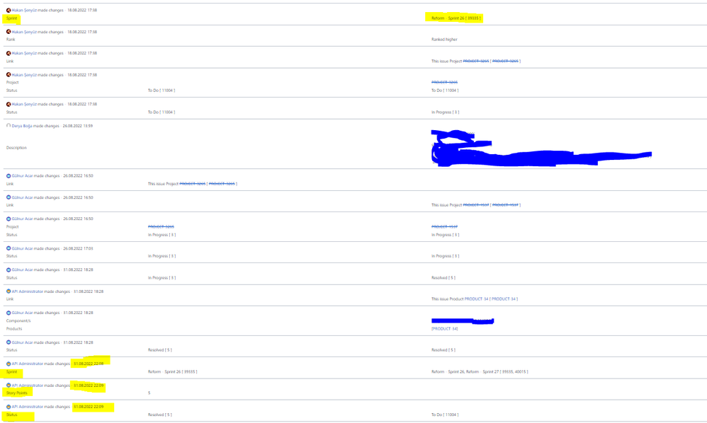

Second screenshot is from the history of that issue. You can see issue is added to the sprint and throughout the sprint, story point is unedited. After sprint is closed, scriptrunner's listener moves it to the next sprint, reopens it and clears story point value. (Last 3 changes)

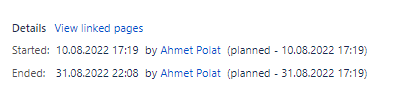

And below, you can find the sprint start and end dates.
