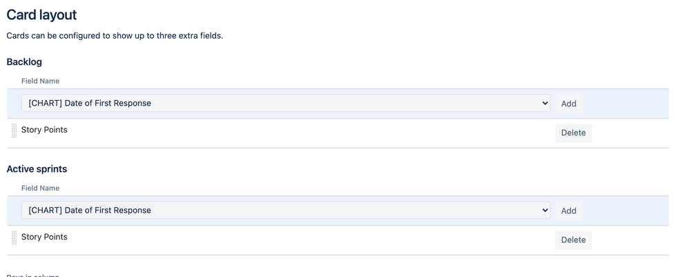

Ramalakshmi
December 15, 2021

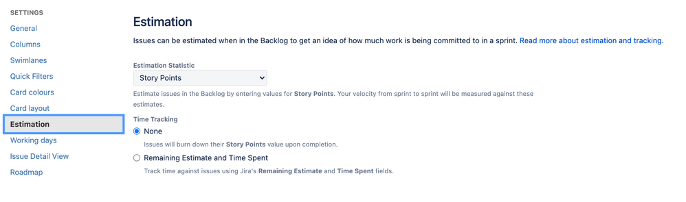

Ok so that is the estimation ’bubble’. Please check your board settings for how estimation is configured. If it is Time estimation then change to Story points if that is what you want there. Board settings > estimation
Ramalakshmi
December 15, 2021
@Jack Brickey yes, it is the case already, please check

Thanks and I assume that the specific issue in fact has SP filled in? Is it remotely possible that you have a custom field named “story points”.
Ramalakshmi
December 15, 2021
yes @Jack Brickey , you can see in the picture the point value "8" after the hypen
yes I have a custom field "story point" that I enabled for this projectScreenshot 2021-12-15 at 14.25.36.png

So you should not have a custom field called “story point” since that is a default system field. It seems that what is happening here is that you have this custom field and you have entered “8” into that field while there is no actual value in the system field. This would explain what you are seeing with “-“ in the system SP field and you see 8 in your card because you added your custom field.
suggested action - remove custom “Story Point” field and use the system field.
