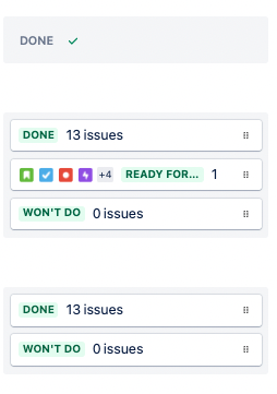

I am not convinced that we are moving closer to the root cause. I'd like to show an example >
  • This is the status of category DONE and as you can see, it counts as blue (in progress)
  • Everywhere else - be it any report, the board, etc - it counts as DONE as it should.
  • I have other custom statuses too .. they all work fine and as expected. Only for this very specific one ... it won't count as green (done) here
Any ideas?

For the one in my example
  • main ticket with "Ready For Integration" and child ticket is "Done"
  • On the Board, everything on the last column

I think we need to see the raw data - could you search for the issues in the done column, and show us the list - Issue type, issue key, and the estimate field are the only three columns we need to see.
