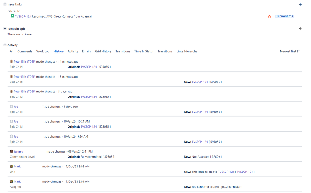

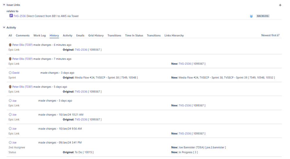

Epic TVG-2536.pngStory TVSEC-124.pngHi Nic, I have attached the history section of the tickets involved. Nothing else changed when the epic link was added.
