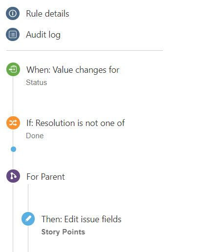

Screenshot below is what I have setup right now with the JIRA Automation, but what I have gathered is that if I change a sub-task status to Complete, the Automation just doesn't apply to that change, and the Story Points are left alone versus subtracting from the Total.  Meaning, the Story Points at the Task level are remaining static.

Here is my Automation screenshot:
Can someone please assist?  I'm not a technical person AT ALL, but I would imagine there is an easy way to do this that makes sense to a non-technical person....

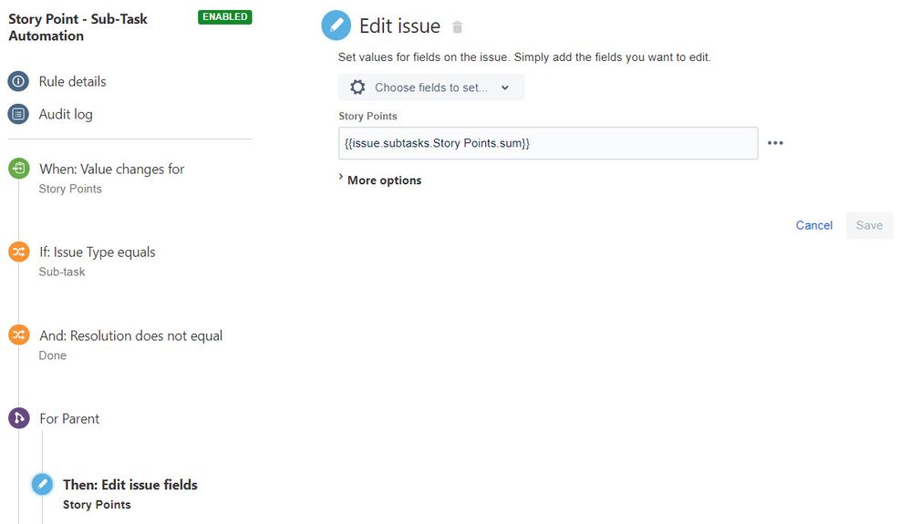

Hello, and thank you!!  I think I'm understanding the concept, but I'm probably not updating the automation correctly.  I tried the below, and the story points are not updating to reflect that status change.  That is, they are not subtracting if the sub-task is updated to Completed.  Here is what I tried:

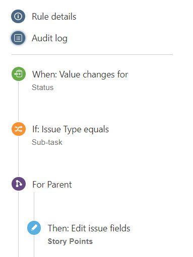

And other attempt:
